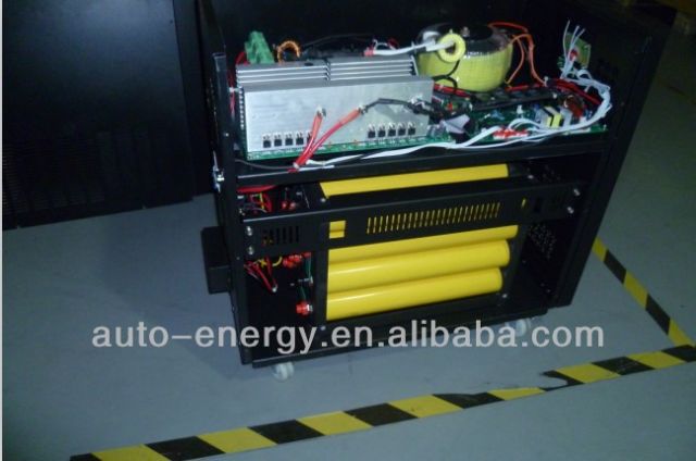

I am thinking of power for a very compact mobile workshop. An upscaled version of this with a small inverter generator. Swap the 12Kva genset for 2Kva and fit my own modular version of Oztules inverter/transformer build.
LFP cells are probably not long life compared to the better LiCo cells. All this stuff is subjective to how they are used and $$$.Edited by yahoo2 2016-04-13
