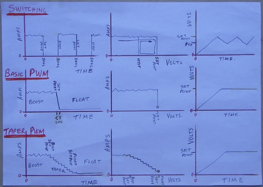

For those trying to follow this thread on PWM regulation, here's a few little graphs for those(like me) who need a little visual input too.
WIND GENERATOR REGULATORS
correction: the two little circles should sit on the 0 line
What we all use(to my knowledge) is the top one.
Gordon's project is the middle one. You Beauty!
And I am about to attempt the lower one.
The area of most concern with my proposal would be displayed by a large circle in the middle graph also shown as a ripple in the Float lines of the two outer graphs.
I hold the optimistic view that it will be well within acceptable levels, so I have to make it and see.
I am a plodder at making things, but it will happen soon.
Edited by Gill 2007-11-07
Cheers Gill _Cairns, FNQ
