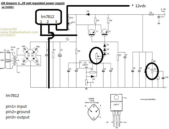

hi . can someone please explane to me which way I connect the trimpot p3
am i correct in thinking at( leg 1 goes to negative)
( leg 2 goes to c10)
(leg 3 goes to r8)
also what is p2? that isnt a trimpot is it?
and do i only use the middle and 1 outer pin on p1?
thanks for being patient with a beginner

Anyway, for the trimpot on the far right of the circuit you connect either leg 1 or leg 3 to ground, and then the other pin to R8. The middle pin (leg 2) connects to C10. That allows you to connect the trimpot either way round for ease of access.
P2 looks like its probably a potentiometer (aka pot, or variable resistor). In that circuit I think its controlling the output voltage.
Is the 7812 portion added by you? If your just planning on using it as an extra line for running some small stuff then it might work okay, but you should probably add some output filtering. You won't get 6-8 amps out of it though if that is what you are expecting.
I've been seeing a few power supply posts from you - what are you actually trying to do?

the 7812 i put in to run my 12volt cooling fan and supply to my usb charger which requires a 12v input. thats all i use the 7812 for
it says the following on the page of power supply diagram
P2 47 Ohm or 220 Ohm 1 watt * (be sure you can reach 0 ohms as any resistance limits the current)
I like to know what it is and how to connect it.

Unless you wish to have adjustable current limiting in your supply you can use a piece of wire instead of P2. If you do use it then it has to take a substantial current which will produce heating. Hence the 1 W (as in Watt or power) rating. If I was building the supply I would connect directly from the OUT leg of the LM317 to the bottom of diode D9. Save money.
I would put a 100nF 16 volt (or 25 volt) capacitor on the output of the 7812 else it may become unstable. It wouldn't hurt to do the same for the input. Put them close to the 7812!

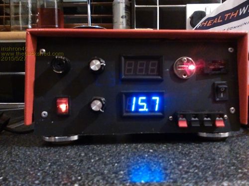

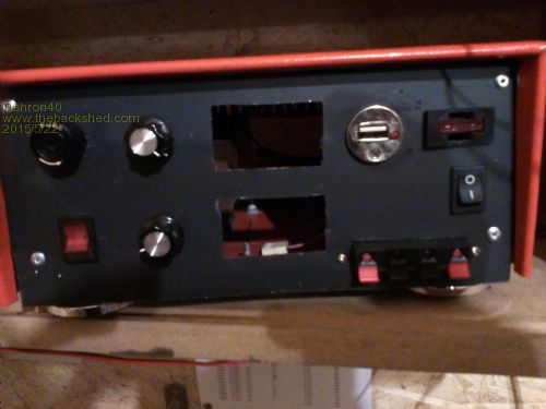

I am after building this casing.
it has main power switch and fuse on the left
2 openings ( 1 for amp meter for current limiting , and 1 opening volt my combined volt ampmeter , as I also like to see what current my load will be drawing)
on right it has a 5vdc output which will accept 12v in.
also a fuse and switch to switch of output temporarily
it has speaker connectors and just have to fit my original bench suppky output fittings.
this is my first project and i do have a lot to learn, but Ill get there.

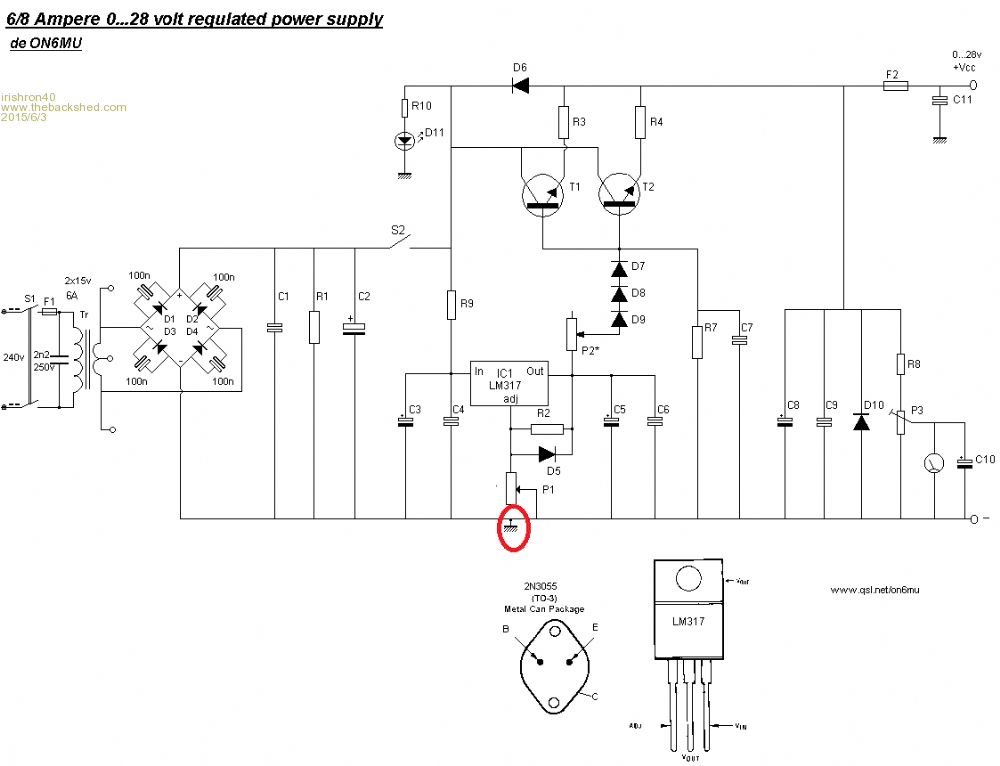

just have 3 questions to finish my project.
1
in attached file I have a red circle around a neg connection. why is this illustrated? isnt it a negative connection anyway ?
2
P1 shows middle and outer leg connected. what do I do with other outer leg of potentiometer
3
C8 is a 330uF/50v
I dont have 330. how important is this vallue in this location?
thanks.
ron
Posted: 01:32pm 25 May 2015
1. Its connected to the chassis. Not necessary, but note C11 and D11 are also connected to chassis, so these will need to be connected to the -ve rail.
2. Nothing.
3. Its the output filter cap, so you can use anything between say 220 and 470 without any affect.
