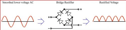

Have a look at the image below.
On the left is an AC voltage. In the middle is the rectifier and on the right is the DC output with NO capacitor. You can see that it consists of a series of pulses. The effective voltage output is somewhat lower than the pulse peaks. Your meter sees a kind of average. Your motor may not like it because it's a bit like a rough road with ups and downs.

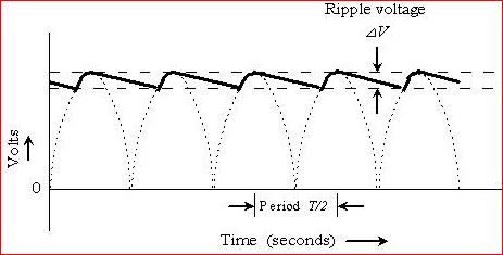

If you put a capacitor on the rectified output you get a picture similar to the image below.
That rough road, representing the voltage, just got a bit smoother. How smooth is the next question. With no load then it may be very smooth. The more load then the more ripple (as it's called). You can compensate for load by jacking up the capacitor. There are limits to this and in practice, you always have some ripple voltage.
A couple of extra points. The average voltage will now be seen by the meter to be higher and if you load the circuit you will increase the ripple and the measured voltage will be lower. There is also the capabilities of the transformer to be considered. More load and the voltage goes down.

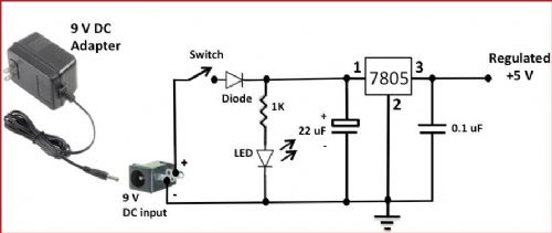

The way to put a bit of stability in your output voltage is to use a regulator which will all the input voltages to vary and still keep a steady output voltage. See the image for an example of a regulated output. The input to the regulator is about 9 volts and may vary a bit (not too much!) and the output stays fairly steady at 5 volts. The 7805 is a commercially available integrated circuit designed for regulation. These regulators can come in many voltages and load capabilities.
