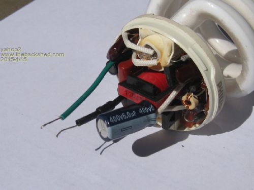

I had a try myself and ran into two issues.
the first was I couldn't solder to the high voltage wire on the Phillips unit, it seems the factory didn't either the filament sized wires are wrapped around the pins on the board, at the time I only had my small iron with me so I couldn't get enough heat to tin the pins and solder directly to them.
the second issue is the drive board is a little wide to fit into the space inside the case of a single flouro luminaire. It is still a work in progress for me while I sort those wrinkles out.

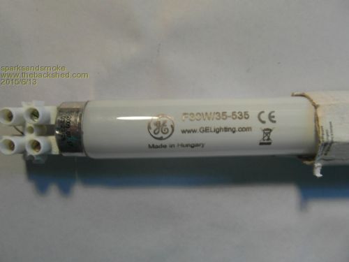

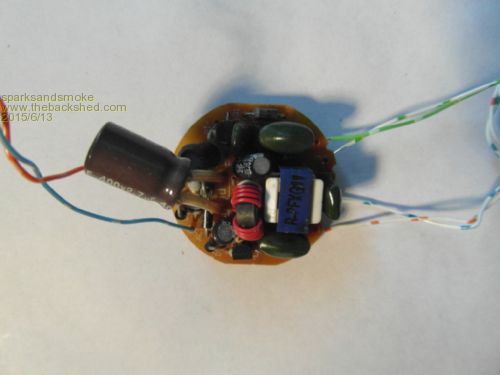

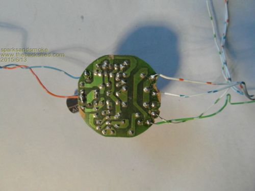

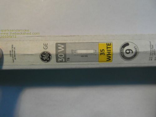

Posted: 10:39am 13 Jun 2015
Apologies for my late reply, life got in the way.
The donor was the 8 Watt version of this lamp:
