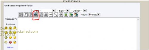

Posted: 12:57am 12 Mar 2015
  Quote  link seems to do is bring up some horse s**t advert.
That is why you need to use this function on the forum to insert a link.
Pete.
