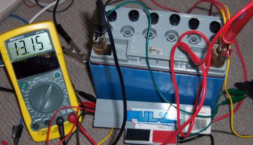

And after breaking in and gradually topping up with water

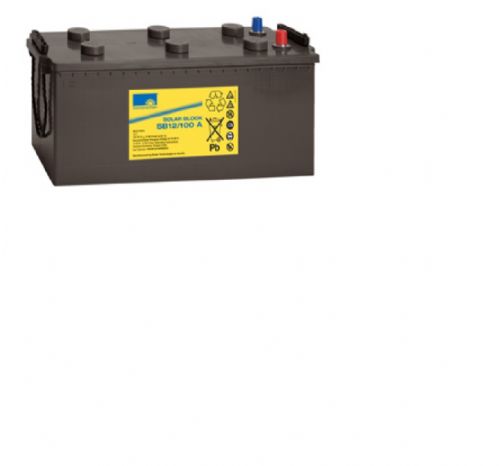

Thanks for that gentlemen. Heres a pic of the batteries I have. Under the round caps is a screw in plug. And yes the gell doesnt look like gell anymore. It looks more like lumps of ice so ill try slowly adding water to try and re hydrate it. Ive actually had one driving a 12v water pump watering my veggie garden for about a week now. The pump draws about 7 amps and runs for about 20 min every night and the battery is topped up by a 10 watt solar cell each day. All appears to be going as expected. Ill get the rest out of storage shortly and start sorting them out. I have a 6 amp charger and also a diesel ute with an 80 amp alternator if I need a bit more oomph, ha ah. Thank you once again.
