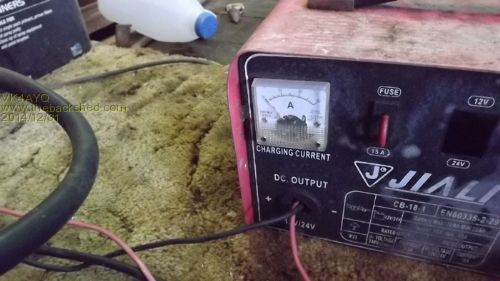

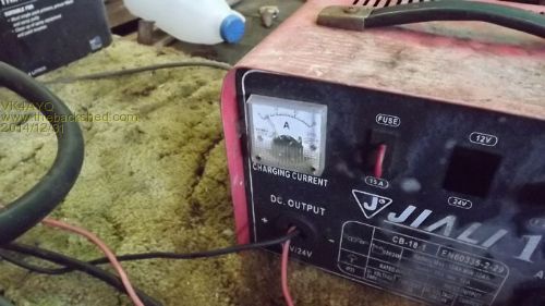

The 32 volt equalization is a theoretical voltage where all the sulphation is desolved and if that is done it is supposed to stop the slow deterioration of lead acid batteries over a number of years, in practice I have found that using desulphators achieves this end without boiling hell out of the batteries, your comment on blowing the desulphator on 24 volts is unfortunate but you can use two 12 volt units across the bank with even better results that a single 24 volt unit.
An actual meter reading on a 500 AH 24 volt bank I am re hydrating at 29 volts.
An actual meter reading on a floating at 27.5 volts, also re hydrating.
In the battery rescue thread I have also included the circuits of a 12 and 24 volt desulphator, they come highly recommended, I am getting the bits together to build a few 12 volt versions as I found that they work better than going across the 24 volts, on a new battery set i think the 24 volt one would be OK but in my case my battery bank needed a bit more to bring it back up as it had dehydrated over the last 15 years and the reclaiming has been a bit of a drag but is working.
