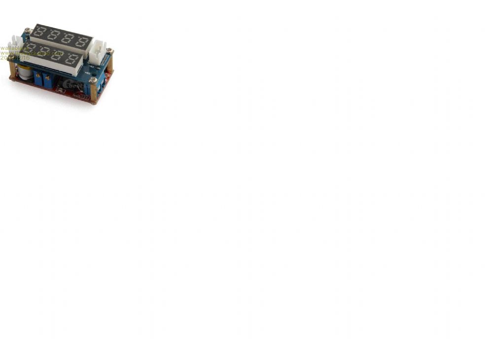

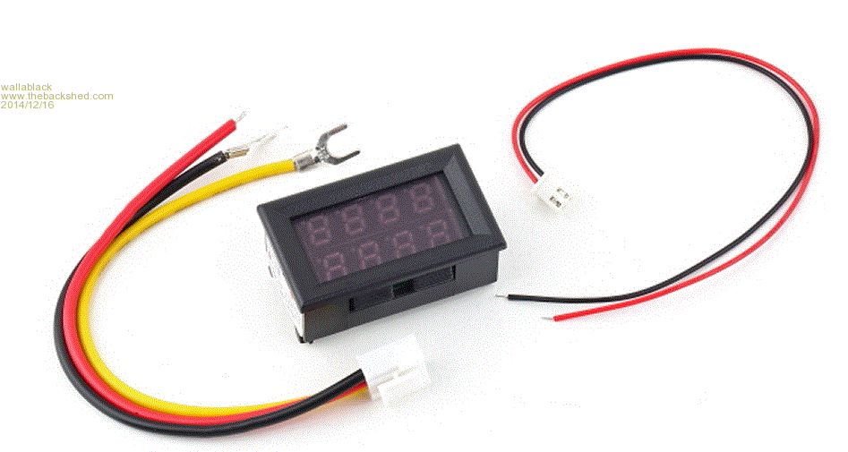

I am in the process of converting an old 300W ATX PSU from an old computer into a bench top power supply which will be more than handy.
Plan is is to have a stable 12V and 5V power supply. Both the 5V and 12V will run into a voltage converter (boost buck I think they call them)so I can have a bit of regulated power.
The ATX conversion was pretty easy thanks to Dr. Google.
My issue is is that I have noooo idea what size shunt to use for the amp meter below.
WHAT SIZE SHUNT DO I USE?
Ill have three of these...
One measuring 5V
One measuring 12V, and
One measuring "Boost Buck" OUTPUT.
Specs are:
Operating voltage:DC 4.5 ~ 30V
Measure voltage: DC 0 ~ 100V
Minimum resolution(V): 0.1V
Measure current :DC 50A (require external shunt)
Minimum resolution(A): 0.1A
Operating Current: <20mA
Display: three 0.28\" LED digital tube
Display color: Red (dual display)
Dimensions: 48 x 29 x 21mm
Mounting cutout: 45.5 x 26.5mm
Refresh rate: about 500mS / times
Measure accuracy: 1% (± 1 digit)
Operating temperature: -10 to 65° c
Operating Humidity: 10 to 80% (non-condensing)
Working pressure: 80 to 106 kPa
The wiring is as follows...Not much to do with the shunt size but I thought I'd throw it in for kicks.
Black line (thin): vacant or buck circuit (module) negative
Red line (thin): power supply+
Black line (thick): COM, common measuring
Red line (thick): PW+, measuring terminal voltage input positive
Yellow line (thick): IN+, current input+
(Please refer to the wiring diagrams for more details)

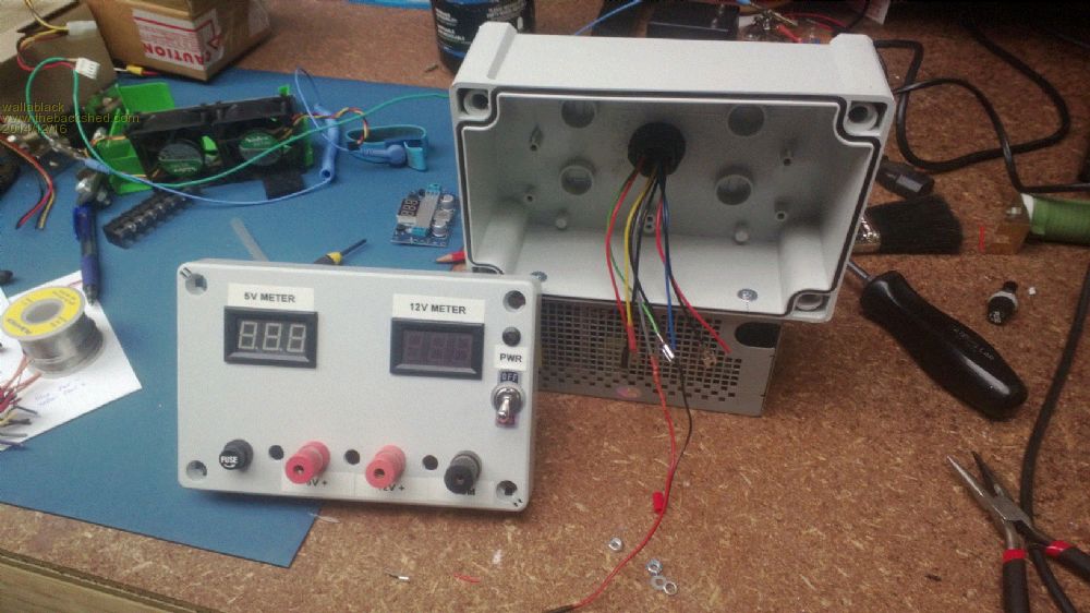

Progress on the power supply.

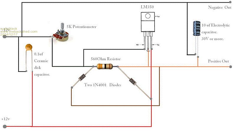

If anyone has a decent schematic or "how to" to use a pot etc to make the 12v and 5V adjustable please let me know...Dr. Google is good but also confusing lol.

I think there is some important information missing. For 50A what voltage do they expect across the external shunt? 100mV is common and Jaycar may have something. Don't see why is it limited to 50A, maybe that what the readout is set up for.
You can't do anything about the voltage ranges, as 5 and 12V are within the current voltage range. You could add a DC amplifier to make 5V put out 50V to increase resolution. But, that would be not be an easy task. Do you need more than 0.1V resolution?

God I wouldn't be expecting to use anything over 10A...One shunt will measure amperage on the 5V side, the other on the 12V side and the third will measure the variable voltage of 12V to 30V produced from the voltage converter/boost buck thingo.
I actually want to do without the voltage regulator circuit board and make the voltage variable with a pot similar to the following one I found.
I would imagine the off the shelf ammeter/voltmeter is just at 50A because it "sound" user friendly...who knows.Edited by wallablack 2014-12-18

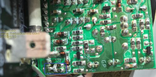

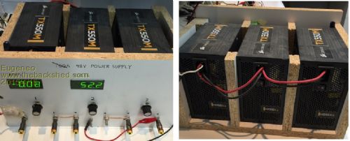

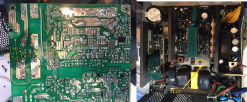

In case anyone is interested - The Corsair 550 watt non-modular version has a TL431 on the output side before the optical isolation feedback and can be converted to a variable voltage supply with a single pot and resistor from 3.5 to 15V (careful of the cap rating). You can put an shunt op-amp to feed back and get a switch mode regulated current supply as well. I suspect all the newer power supplies use this type of circuit and can be converted. Careful - if you decide to disable the current limiter, the thing can supply a few hundred amps and surprisingly not crater.
My local computer store had these on a blow out sale for like $30 so I bought 4 of them and now I have a 50V - 50A continuous variable supply.
Let me know if anyone is interested and I can dig up the mods.

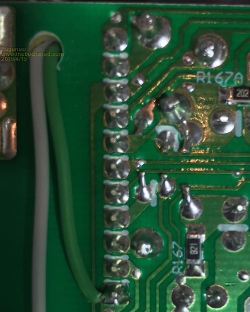

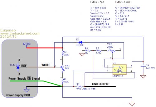

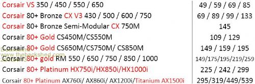

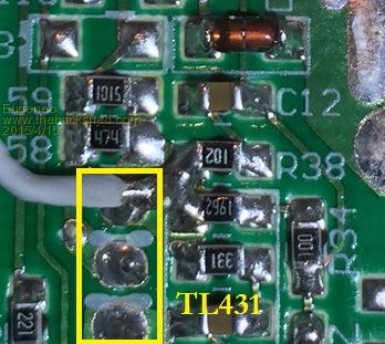

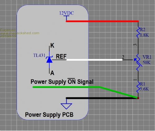

I'll dig up the photos and post them up when I get a chance. The particular model would probably be a couple years old now but I will get a model number just in case they have it for sale.
I can only assume that the other Corsair supplies would all use the same type of topology for the feedback circuit. Basically it's really simple. you will need to find the TL431. It's a TO-92 package with three terminals.
The Anode was connected to the ground.
The Cathode is connected to a resistor then to the input side of a optical isolator (4 pin dip).
The reference is connected to a 2 resistor divider.
All you have to do is put the pot and resistor between the high side of the 2 resistor divider and you have voltage control.
I used a 50K ohm pot with an inline 10K resistor.
To make sure you are soldering the connections in the right place, you can measure the reference to Anode and it should be very close to 2.5V
WARNING: Be VERY careful when you do this. The high side DC voltage can be 170 to 400 VDC depending on what your AC input is.
There's a stand-up module that controls the PWM to the fan based on temperature and current load / overcurrent trip / power on input (green wire).
You need to disable the overcurrent trip by cutting the trace.
I'll try to post the rest soon.

Posted: 02:53pm 14 Apr 2015

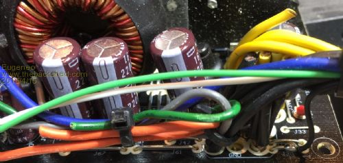

Wow, I don't remember it being this complicated!
Completion
PCB
Bring out a Green wire
Bring out a White wire
Bring out a Black wire from any ground
Bring out a Red wire from the +12 volt rail
Solder these if you want the over current protection disabled (optional)
The connections to the pot. These resistors values will give you about 3.5V to 15V output
Use this circuit if you want to current limit using VR2 from 1.48A to 50A
Good luck!
Edited by Eugeneo 2015-04-16
