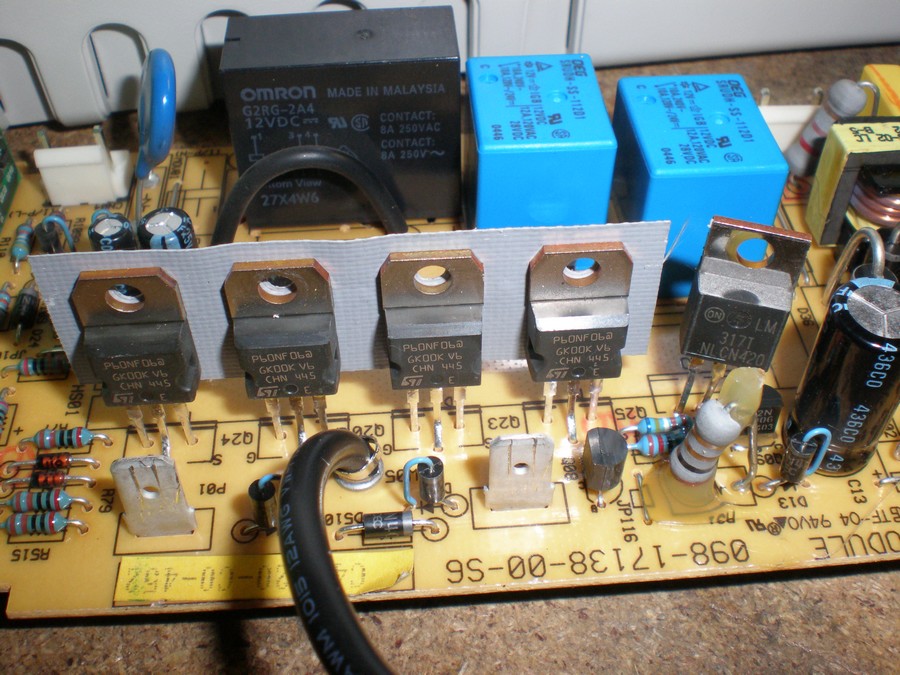

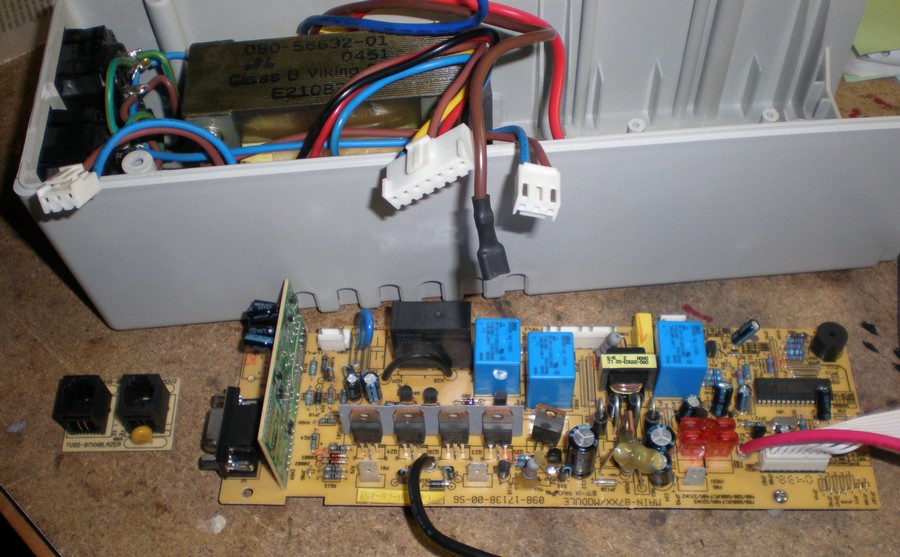

Ok! So got hold of a discarded UPS and opened it up. Below some pics... (I removed a big heatsink to make things more visible). Some useful looking relays in there, if nothing else...
A very amusing bit was a little board with the two phone jacks. It was connected to... absolutely nothing! Looked good on the brochure maybe!
So I am thinking of connecting it to a battery and seeing if I get clean AC out using an ancient 'scope I have. Warnings/comments/predictions welcome! I wonder if the transformer is needed, or if that is only used for AC->DC stepdown?
One hitch is I run at 24V, and this UPS had a single 12V battery. Should I wire it to one battery only, or would it be better to use something like a pulse train into a mosfet to step down the 24V to 12V?

Oh, worrying new fact - the battery was at 12.7V and seems like it can still deliver current (drew 4 amps from it for a few seconds). So does that mean its the circuitry thats broken??

If the UPS only had a single 12v battery then it wont work when connected to a 24V battery bank. It will, most likely, make a loud bang and some foul smelling smoke.
Many UPS's wont fire up by themselfs on battery power from a turned off state, they need to be connected to the 240VAC power first. The easy test is to connect it to a good 12V battery ( car battery ) and see if it turns on. If not, then I thinks its beyound the scope of this forum to describe any modifications to make it act as a self starting inverter.
If it does start up on 12V, then yes you could use it as an inverter, but I would suggest a few modifications as these little cheap UPS arn't designed to run for more than 20 minutes. Bigger heat sinks on the MOSFETS, plus a cooling fan is a good start.
Also be careful, a UPS is as dangerous as any 240VAC power supply. Use the old one hand behind your back safety measure when making any test runs.

Thanks for warnings Glen. I will work in a state of paranoia.
I put one good battery on it and it works 100%. Can start from cold (no mains present). I used a small fluorescent tube as a test load. When the mains is switched on, a relay clicks and its back to using mains power. Irritatingly, it seems to have a warning beep when no mains is present. Nothing a pair of pliers won't fix! Maybe I'll replace it with an LED.
I looked at the AC wave form on an old scope, and it looks like a horrible sawtooth shape! So I assume this is not a pure sine wave inverter.
Perhaps I'll screw some more ali with slots cut out on top of the existing heat sink, and drill some air holes in the case and see how that goes heating wise.
