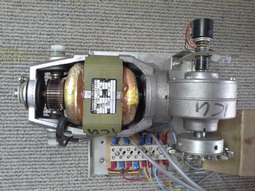

Wondering if anyone would have an idea of how to wire up this salvaged motor, it has 2 wires to the brushes via a small transformer and two to the windings of the stator. other wires go to a rotary encoder. Rotor coils seem ok by resistance test.I am only interested in running this in one direction and at a constant speed. Detail Plate reads Groschoop & Co 4060 Viersen 1, 220v, 0.62A, 2000min-1, 80 Wcosp. Can't find any info on the net

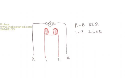

Thanks for the reply Pete. Just traced the wiring by continuity and the 2 fields are in series as is the armature which makes it impossible to go field1-armature1-field2-armature2? am I right? see sketch of circuit as it stands. Only way would be field 1-field2-armature1-armature2 unless I am getting it wrong completly. Thanks Cheers

If it were mine I'd power in A & 1 and join 2 & B.
if it rotates wrong way power in A & 2 join 1 & B
because it has commutator and brushes it will run on DCEdited by rustyrod 2014-11-15

Rubes, what you show as *two* fields is considered ONE winding. It has to be arranged that way to create a N & S pole (alternating) between them.
Please consider the advice above (joining A&1 + 2&B as a BAD idea. While this *might* work on low voltage DC - putting the full mains voltage across the 82 ohm armature is just asking for the magic smoke to come out.

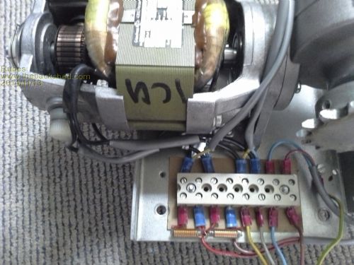

photo looks like (I say looks like, need underside photo) from left
- terminals 1 and 3 are to the brushes
- terminals 5 and 6 are the fields
-- the yellow and ? blue twin wires would not be needed
remove the chokes and all other wiring on this side of terminal strip
the chokes hanging out like that are waiting to bite you
perhaps active in terminal one
neutral in terminal 6
join terminals 3 and 5
IMPORTANT screw a good earth to the frame of the motor
if it runs the gnorw way swap the black field wires in 5 and 6
IF you need to use all those other wires for what you are doing you are on your own.Edited by rustyrod 2014-11-15

Thanks guys I will give it a go in the morning, anyone notice what is written on the motor with a marker pen (its upside down) lolEdited by Rubes 2014-11-15
