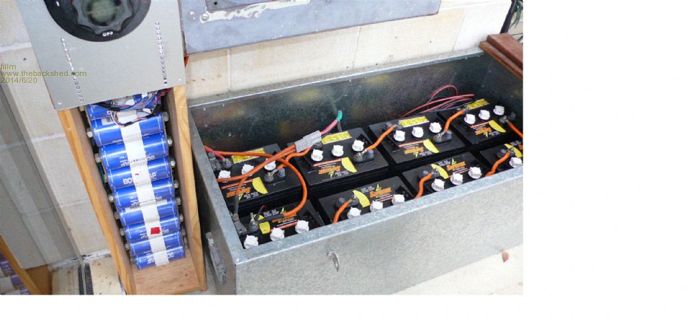

Ultra-Caps are very viable option to add into a Grid Tie system. I have had this set up for a number of years now. I do not know why because some engineering student does a 45 page thesis all of a sudden make it a discovery as buses and other forms of electric vehicle applications have been using ultra caps for power recovery on regenerative braking for quite a while.
With wind/solar it is no different, as gusts and solar bursts cause rapid power spikes and overpower batteries causing damage because of the slow response time of grid inverters to match these spikes.
Before I added the Ultra Caps the voltage line on my logger over a day looked like it was recording a R9 earthquake, after adding the Ultra Caps the line is not totally smooth but everything reacts at a controlled pace , as well as reducing the lost power due to the solar being backed off and battery losses due to gassing .
I have 25 x 2.7V 3000 Farad Maxwell Ultra Caps that are in paralell with a 48V / 225A/hr battery set , they can be switched to be run as separate systems or together which is normal. The ultra caps can absorb 8000W for a period of 30sec with a voltage rise of 53 to 60Vdc , so this easily absorbs wind gusts and solar bursts .
Here is a pic of the Ultra-Caps / Batteries , there are 2 x PVE 1200 Grid Inverters feeding off the system , 2.5kw of Solar and at present I have 2 x 2kW Chinese wind turbines up for testing , one with the GOE Blades opposed to the Factory supplied blades.
I posted some info some years back when I fitted them and after that Tinker also added them to his system , I do feel they have a place in grid tie systems such as mine but as for Off -Grid I can see no benefit. If you are getting rapid voltage Spikes means your batteries are to small or buggered.

Yes , you can use Ultra Caps to absorb wind spikes and but its no good putting a undersized set in because of cost and expect it to work . From memory the 25 x 3000 Farad Ultra Caps cost over $700 , Batteries $1400 . Thats 9.5+ megawatts of power it has to make to break even, I am never going to see that day.
As I mentioned , I put the caps in because of the lag time on the inverters , the PVE 1200 is the only one on the market that is low voltage . Latronics do make a unit that will connect a wind turbine to the PVE 1200 with no batteries , it is basically a set of caps but there will always be the problem with AS4777 connection time of 60sec +, which is useless for wind so batteries and solar/wind works.
There are other options but none of which are legal , so if you want a legal and compliant wind grid feed in AUS there is not many options.
To answer about the balancers , yes they are fitted with just basic LED / diode across each Cap, which I have just added a resistor in (advice from a friend GW@PE) to trial and it is working unbelievably and they seem to be settling at 10 ~ 50mV difference. I have just put them back into the system as I was using them as a test battery bank for setting up a stand alone Wind/solar/ batt 48Vdc deep bore pump control
