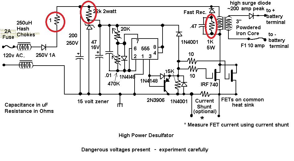

I want to build several high power desulphators to rejuvenate second hand golf cart batteries for my solar power.
I have found here plans to build them however it runs off 120 volts AC. Could someone with more than my limited electronics knowledge be able to help please.
If I double the value of the resistors circled in red and half the number of turns on the transformer on the charger side, will it work the same as the original circuit but with 240 VAC power?

Hi Madness
In theory, yes, doubling the 2 left hand values might be all thats needed. The other one I don't think matters.
But....
I would not build this circuit! Its highly dangerous, even at 120vac. 240vac is just asking to kill someone. Most of the circuit is connected directly to the mains power, and any fault finding or tinkering on your behalf will very easily kill you. Seriously, stay away from this circuit. I've been involved with electronics as a technician/electrician for 30 years and I wouldn't build this circuit simple because I fear a careless moment in testing will kill me.
Also the circuit is not well designed. Only using a half wave rectifier on the input is not good practice, especially for a high current application, and there are a few odd component choices.
Seriously, don't build this circuit.

Posted: 01:23pm 18 Dec 2013
  Gizmo said   Hi Madness
But....
Thanks for the advice Glenn,
Would replacing the dangerous part of the circuit with a DC power supply still work the same, I am wanting to use this on 48 volt battery banks?

Posted: 02:05pm 18 Dec 2013
Surely the dangerous voltages problem could be obviated by replacing the AC input with a transformer "plug pack" of suitable size and output volts.
Do you have any output transformer data wrt number of turns, wire size etc?

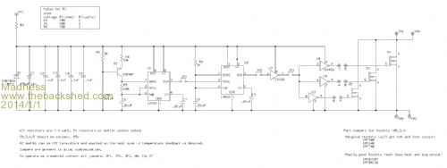

If any one is looking to build a high power desulphator that will work on batteries up to 48 volt look here.

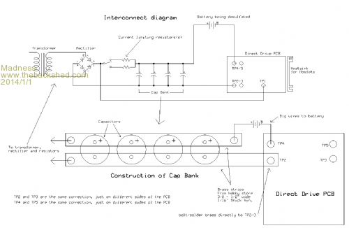

Posted: 04:59pm 31 Dec 2013
I have started to build the circuit in the link above, it uses a capacitor bank sitting at about double the battery voltage. Three Mosfets switch the capacitors to the battery at 1 khz for 50 microseconds or something like this. I have got an faulty surround sound amp I am using the case, transformer and heat sink from. The tranny puts out 60 volts, not sure of it's VA rating but it is a fairly big transformer.
This setup is supposed to capable of up to 200 amp pulses.
