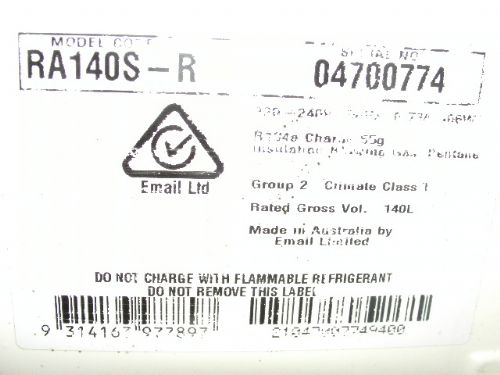

For the record so far from the model numner all I know is it's a Westinghouse Bar fridge/Freezer, about 10 years old (Don't know what you mean about frost free, but this thing ices over like the north pole, forever having to defrost it, it works too well to be honest!).
Rated at 2.5 Stars in the energy rating department. Energy consumption is 376W. Fridge is in good condition, well looked after. Been in storage for approx 5 of the 10 years I have had it. Recently been used on mains and running as it should.

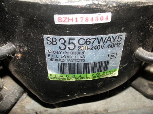

Posted: 05:32pm 15 Nov 2012
This has been sitting unused for about 6 months...
Door seals fine! The freezer just ices over the shelf wildly sometimes! Cant complain really. Takes over a month or so to build. I can run the thing on the lowest setting and it is sufficient for my needs. Holds a weeks meat and veg for me so....

It says 0.6A full load.
If starting load is 10 times that, inverter needs to allow for 1500W surge.

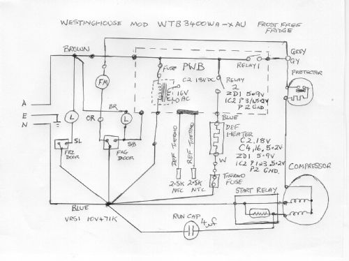

The compressor starts short cycling, and the inverter may have a VERY difficult time.
Another interesting thing to be aware of.
Most if not all, frost free refrigerators have a heating element(!) located behind the evaporator plate.
When the compressor turns off, the heating element comes on.
The idea here is to heat the evaporator plate up to just above freezing, to prevent ice buildup.
A terrific idea, and an absolute energy killer.
You can disconnect this, it is usually connected directly across the motor contacts located within the thermostat. But then the evaporator plate will very quickly ice up and require frequent manual defrosting.
No simple easy solutions to all this.
