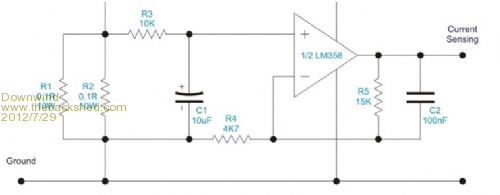

If you want to use the shunt then here is a circuit you could try with a LM358 opamp.
I have not tried it myself but it would be a start, the output would need to be feed back to the second 1/2 of the opamp (dual opamp in a single package) and a voltage reference used to set the relay trip point.
The top of the circuit is missing (not needed) but the opamp was supplied by 5v i think, and the other line not marked was the V+ side of the shunt.
Note:- R1 and R2 are your shunt and not needed to be added to the circuit.
Pete.
