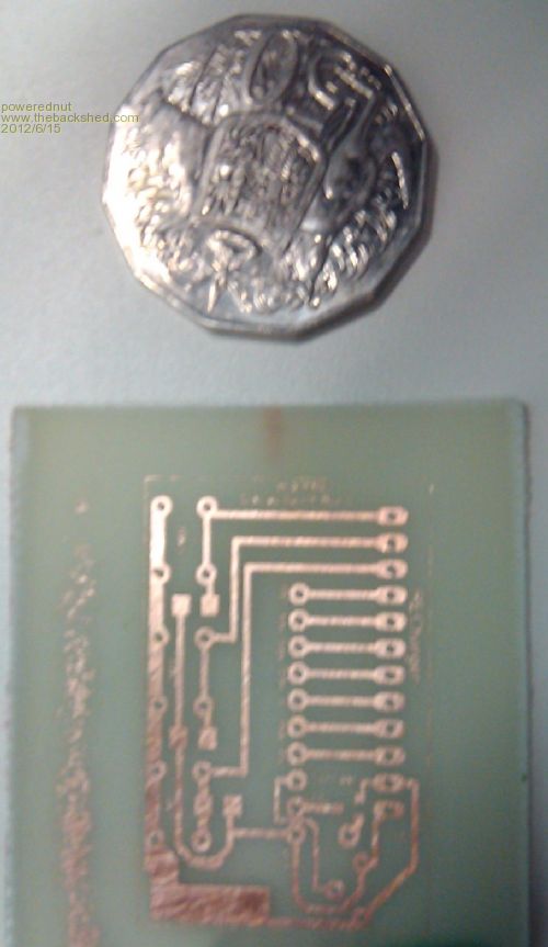

Posted: 03:50pm 14 Jun 2012
Sorry about the dodgy quality of this image... I've only got my phone here to take it with today.
The 50c piece is included for scale... the crappy copper on the left is from when I pulled the board out of the echant early. Its outside of the board perimiter and will be trimmed later. most of the tracks are 0.024", but there are a couple of .012". I havn't tried anything below that - I suspect its the limit of this method. The square pads without holes are for 1206 size SMD resistors. The lettering is readable in most cases and is set at 0.032". The board perimiter is mostly intact, despite how it looks in the photo.
*edit* wow.. that looks even worse than the origional did. You can't tell from the photo, but those pads near the bottom right arn't actually joined up.
Edited by powerednut 2012-06-16
