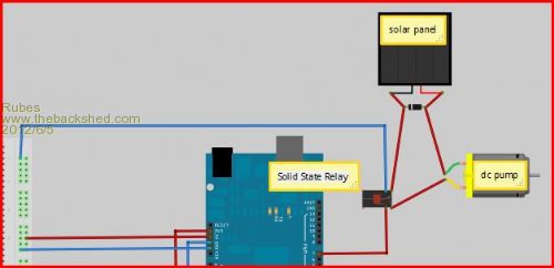

Attached is my circuit, consisting of 12v dc pump drawing +- 1amp run directly from 40w solar panel which has it own protection diode, pump is switched by optically isolated ssr controlled by arduino my question is, is a reverse biased diode across the load nessasary to protect the power FET in the SSR output from any inductive "Back EMF" pulse that is produced when the pump is switched off, and if so what sort of diode. Currently up and running as is but a bit worried about this issue.

Most SSR's have a reverse protection diode built in.
If you nominate the model and make, or Google the relay
it will be easy to confirm.

I would expect the diode to be across the motor. Its the cause of the back EMF.

if this was my project, throw a schottky diode (rated 3-4 times peak voltage/current dished out by your panels) at the motor, bung in some ceramic cap between the -/+ terminal at your motor and for good measure, toss in an electrolytic at the high voltage end of your relay.
