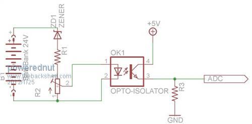

okay, here is a rough concept of what I'm thinking about. The battery on the left is a substitute for whatever voltage source is going to be monitored by the adc.

I doubt that would be even remotely linear. There are special optos to do this, they have feedback to the isolated side but a standard opto would not work IMO. it will also load the source a lot which may or may not matter.
The best way I think it to use serial of some type to transfer the data across the isolation barrier.
For example a VCO powered by the source, or an 8-pin uC sending serial data from its ADC.
What level of Vs are you expecting?

I got around to testing the concept over the weekend with an old opto-isolator. If anybody else cares, Rob was right: its completely non-linear and pretty much non-workable.
Oh well, live and learn.
