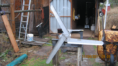

Hey Folks, I would imagine this question has been asked before, I have looked all over the net and can not find an answer. I have stopped thinking about any of the crap on ebay and plan to build a alt. from scratch. I will use either 18 or 20 gauge wire and I think around a 100 turns. And I will make 12 coils, so can anyone tell me how much wire to buy. Will 1/2 pd do or should I get a pound? Also the turbine is 5 foot, would I be safe to build a eight inch setup or could I go to ten? Here is a shot of my blade design. I welcome any remarks.

Hey Roe, thank you for the answers. The question was based on the blades you see in the posting, could I get by with 8 or 10 stater and rotor. I live in a area of low to mild winds.
