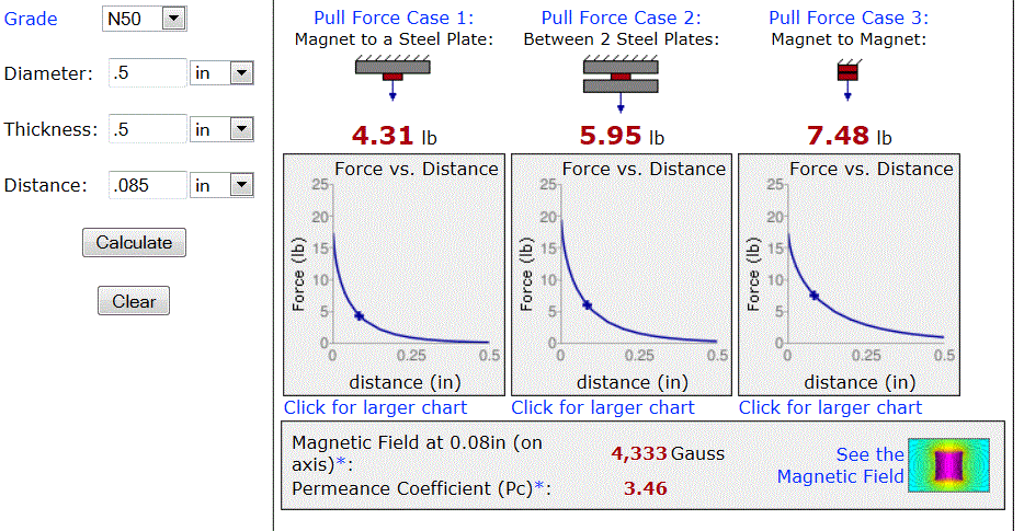

Posted: 09:23pm 18 Dec 2011
Ok heres what I am thinking of ordering 12- N50 discs 1/2"X 1/2" With a Gauss of 4333. Here is all the information on them in the Pics, provided I get them uploaded.
Do you think they will produce a usable amount of power?
