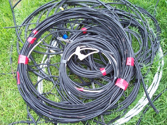

Well I've got a heap of 5mm guy cable, is this any good to use? I'll need to rig up some power poles, similar to the ones in the streets as the cable isn't insulated.

If it's on a wooden pole with the wires well apart, or on seperate poles I don't see the problem, Correct me if I'm wrong.
Anyway I went out and got some cable, I bribed him with a slab and got about 150m of 5mm thick and 30m of 10mm thick for the batteries to inverter.

The guy wires---- most unsuitable for carrying power ,imho, first,they are galvanized steel and very hard to terminate,have a very high resistance and how are you going to solder/bond,Etc. at either end.
Mate, stringing open wires up on poles is sort of lots of work ,just use what you have in the pictures ,but make sure you solder them very well where they have to be joined--you'll have to use a gas flame to get the required heat as the (those) copper cables will disapate any soldering iron heat like mad ,and you won't get a good solder flow ,if any.
Low voltage, now this just adds to the loss problem, you see, if you were,say, running 240 volts through those guy wires ,then maybe you would lose a few volts , but running 12volts or even 24 v you will have a very big voltage drop -not worth the effort,.
I run 100 Mtrs and use 16mm insulated copper ,laid where necessary ,just on top of the ground. I have paid special attention to the connection joints ,thermo heat shrinking all joints after very careful soft soldering and , multistrand soft welding type tails into the control panels _where you have to get around corners ,Etc.
I have plenty of extra cable and will "double-up" one day ,making 32mm cross-sectional area.

Seriously, my instant impressions were the same as yours - galvanised steel rope, or stainless steel rope - neither of which would be suitable for the main power lines, especially so at low voltages and over significant lengths, and for exactly the same reasons as you quoted.
What he has photos of is NOT what I would call "guy wire", although it MAY be hard-drawn copper. Would need to feel it to be sure.
Running cables off wooden poles is bad karma unless you use suitable insulators. Sure, it will "probably work" for quite some time at low voltage, but it will cause grief sooner or later.
