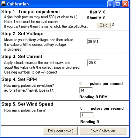

Cindy I just noticed your using the old PicLog software. You need to use the latest version 2.0, its got a lot of bug fixes and is much more reliable. Please read the full article, 5 pages in all.

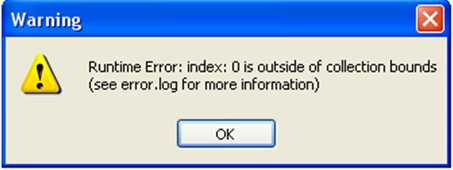

We downloaded the latest version software, however, there is a mistake occured whening running it, here is a capture of a screenshot. Please kindly have a look and let me know what happened, thank you so much!!
Surf with the wind!
Posted: 11:37am 15 Apr 2011
Need to see the error log Cindy.

I think here is the error log;
Error log timestamp Friday 11/04/15 19:53:54
Runtime error: index: 0 is outside of collection bounds

Posted: 01:11pm 15 Apr 2011
Did some research, looks like JustBasic, the platorm PicLog 2.0 was written in, wont work on a PC set to run in some Asian locations. Dont know why, it was meant to be fixed at a later date. Out of my hands.
Re: Runtime error: index: xxx is outside of collec
Post by Stefan Pendl on Feb 20th, 2006, 12:07pm
Just BASIC .TKN files will not work on Asian localizations untill v1.02 is released.
Lberty BASIC v4.03 allready contains a fix for this, Just BASIC v1.02 will be based on LB4.03.
http://justbasic.conforums.com/index.cgi?board=novice&action =print&num=1140451712
All I can suggest is you go back to using the old PicLog software. The old software does work, but its buggy and may crash from time to time.

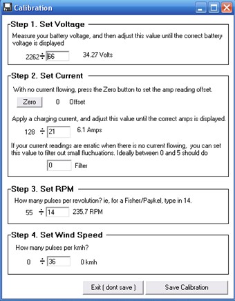

Now we tried to input 36 in the blank, but the number came out is quite strange, please kindly have a look at the following two captures of the screens,
No. 1 (when setting the wind speed, we input 36)

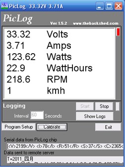

No. 2 (then we get the result when the wind speed is 1kmh, the RMP is 218.6 )
which we think it is a kinda impossible, there is no way to reach such a high RPM when the wind speed is only 1KHM,
Because 1kmh equals 0.27778 ms (1kmh=0.27778ms), and the starting speed of our anemometer is 0.8ms, which is to say when the wind speed is 0.27778ms, our anemoter doesn't even start to turn yet ....
we also tried to use the number of 2.7778, which will get a more reasonable result. so, what do you think? is 2.7778 okay?

Posted: 11:32am 18 Apr 2011
Hi Cindy
The old PicLog uses a divider, the new uses a multiplier, The figure of 36 is based on a multiplier and wourl work for the new software. As your stuck with the old software, you need to enter 0.0277 ( thats 1/36 ).
Posted: 11:36am 18 Apr 2011
The best way to calibrate a anemometer is with another anemometer, or wind speed meter. There are a lot of variables popping into the mix here, old software, different circuit, and a anemometer that I'm not sure if it is calibrated or home made. Using a known calibrated measuring device, like a wind speed meter, is the only way to get the PicLog reading accurately.

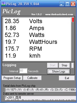

With your help and our engineer's effort, we decide to use the number of 2.7778 and the logger works!!! Here is one picture for your reference.
Thanks very much for your help and input, we really appreciate it!
