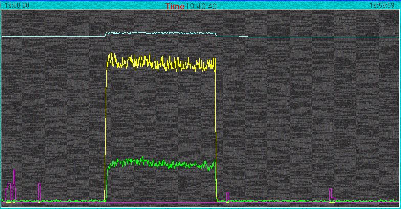

I have had the opportunity to see how multiple GTI interact with a battery RE system.
My setup has shown that transformer coupled GTI should not be connected together on the DC side.
I have a solar panel with an outback MPPT supplying a battery. A PowerJack GTI is controlled to turn ON when the battery has excess charge that needs to be diverted. I also have tested a 50Hz transformer coupled latronics GTI across the solar panel as well. The theory was that when the battery is full, the MPPT will shut down, and allow the solar panel voltage to rise to a point where the latronics GTI would reach cutin voltage and surplus power would go out to the grid. NOT SO!!.
The Latronics took power from the grid, in the reverse action, as a synchronous battery charger. This power was recycled through the Outback MPPT, to the battery, and then back to the grid through the PowerJack GTI.
I will need to add diode blocking to prevent the Latronics from reverse acting this way.
Here is the proof of this happening.
The tell was the 15minute duration. This is the length of time the Latronics stays connected after first woken up to try and sustain a grid connection in low wind conditions.
The use of current shunts to measure power will not easily pick up this behaviour. It happened twice, so was not just a glitch.
Gordon.
PS edit: the outback current was the yellow trace, tthe Powerjack current was the green trace. The Lt blue trace was the battery voltage. The battery was clearly being recharged during this time, due to the jump in voltage.

Hi Gordon
I cant get my head around how it is going backwards through the Islanding on the outback, I realize there is a sensing current but how it is able to get significant current back to the battery has me tossed.

Hi Bob,
islanding is about AC connection, and AC impedance.
As far as the inverter is concerned the AC is OK.
The H-bridge that would normally drive the transformer is the bi-birectional component. There does not appear to be any direction sensing in the DC current measuring within the Latronics GTI during the 15min window. I have a knack for finding defects, so this would not be an exception. [I have to be careful, pointing out problems with hardware or software has caused me problems here on the forum].
These units could make a good synchronous battery charger if the 15min feature could be controlled.
The blocking diode will fix the problem for now.
Gordon.
PS edit: the outback is a half bridge design solar MPPT, so this component has a bi-directional aspect, anlike a normal buck converter. Current direction sensing controls the internal relay, that turns the unit OFF when current reverses. The Latronics GTI does not seem to operate the internal disconnect relay with reverse current. This may be a design fault with the microprocessor coding.Edited by GWatPE 2010-11-25

Posted: 07:33am 25 Nov 2010
Hi Bob,
I would have replied yesterday, but a forum message stating that I had posted more messages than I was allowed came up. Must be a recent forum Block Gizmo has introduced to discourage SPAM. I must have missed the advice notice when this was sent out.
Anyway, I am not sure about the use of a GTI as a battery charger really. Mine was putting 15A back into the battery during the 15min period. Since the addition of the blocking diode the unit is now operating correctly as a GTI.
