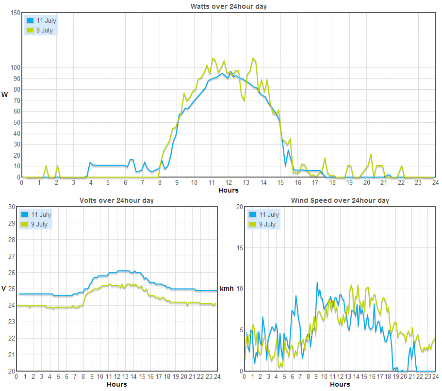

To display the data, I've using a Java graphing script that draws the graph on a web page. At the moment its displaying graphs for watts, volts and wind speed, over a 24 hours period. And it displays two days over eachother, making it easy to compare data from two different dates. More graphs will be added in the future. The graphs are live, so you can see how a windmill / solar panel / etc is performing at any time, from anywhere that has access to the internet. You could be at work and see how your windmill is performing during the day! Below is a set of graphs, display two days on top of eachother.

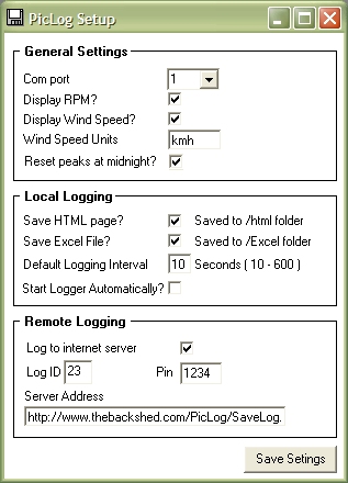

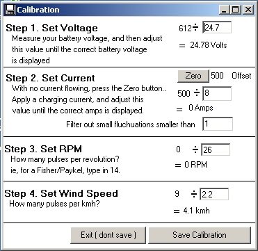

The Piclog software has a few changes. The Setup screen now has a option to reset the watt hours at midnight, the software will either reset the watt hours every night, or keep a running tally. I'll be adding RPM and Wind Speed peak recording as well. Also added is the remote logging options, where you set the PicLog ID and Pin, and server address. The ID and Pin will be provided by me when I set up the server to accept data from your PicLog.
The Calibration screen now has a amp reading filter, to filter out small changes around 0 amps. These small fluctuations can cause tray watt and watthour readings, especially if you use a Allegro current sensor or current transducer to measure current.

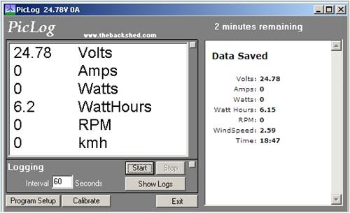

If you enable the remote logging, the PicLog screen will widen to display a extra panel. This extra panel is a mini web browser, and is used to send the data to the remote server. It also displays the web page sent back from the server, confirming the data was saved in the servers database.

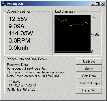

I've been running the updated PicLog and server software for a couple of days now, but I have a problem, as you can see from the PicLog screen above, no wind! So I've connected up my solar panels to act as a power source for testing, you can see the rise and fall in the watts graph above, as the sun rises and falls during the day. Problem is, its not much good for comparing watts to wind speed or RPM, one of the graphs I want to add. So I'm looking for a couple of beta testers, forum members who are running a PicLog on a PC with internet access. If your interested, let me know and I'll send you the updated PicLog software, a ID and Pin to access the server.

The graph test page is at http://www.thebackshed.com/piclog/Report3.asp. Its a pretty intense chunk of java, might take a few seconds to load the first time. Works better in Firefox than IE.

If you are looking at the graph, move you mouse over the points and it will display the values at that point. It will also display any notes the PicLog owner has added to a specific record.

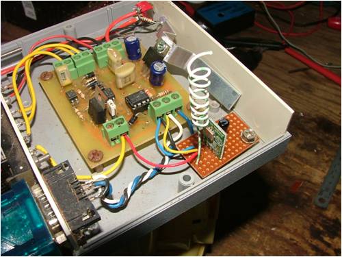

I had to do a bit of fault finding tonight. The data stream to the server stopped just after 7pm. I had a look at the laptop running PicLog and it all looked fine, but it wasnt receiving any data from the com port. I suspected the USB to Serial adapter, but even after a reboot I wasn't recieving COM data. Fired up the CRO and checked the serial output from the PicAxe chip. Again, no data burst. Hmm, had the chip died, do I have a spare?
Multimeter in hand, I measured a few voltages, and discovered the 5v rail was down to 1.8v! Was it loaded? The 7805 regulator was running cold, as was eveything else. I pulled the PicAxe chip and the rail voltage jumped up slightly to 2.5 volts. Ah-ha, a faulty regulator. Swapped the 7805 for a spare and the PicLog burst into life.
I think the faulty 7805 has been stressed in the past, running on 24v without a heatsink. There were signs of heat damage, so I fitted a heat sink a few days ago before I put it back into service. It only gets slightly warm with the heatsink fitted. I now think the original 7805 was damaged and not regulating properly, and gave up the ghost tonight. Now that the PicLog is up and running with a new 7805, I see the voltge calibration is slightly out, and I would guess the amp calibration is out too. I'll re-calibrate these tomorrow.
