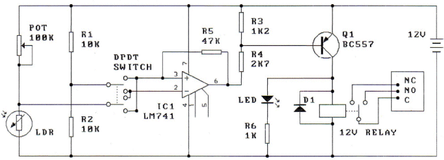

I did find this circuit. Its uses a op amp to provide a bit of hysteresis, to stop the relay chattering as the light levels slowly change.
http://kitsrus.com/pdf/k79b.pdf
The only problem is its for a 12v system. I dont think the 741 IC will last very long at 24v.

LM741 max 36V, just change the relay and everything else should be OK.
