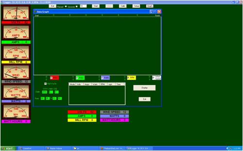

I modified Glenn's Piclog software and added in analog meters i have two versions of it
You can download both here, unzip and put both exe files in your Piclog Folder
2010-06-05_074519_meter.zip
dwyer
Joined: 19/09/2005
Posts: 575
Posted: 01:06am 05 Jun 2010
Hi Windman
That is a great job for adding an analog meter and looks great and better for my eyes I also love analog meters. Well done Mate

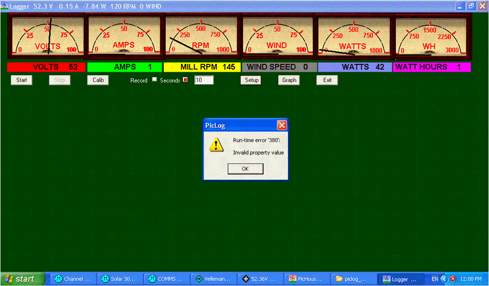

I have been unable to run your program. It seems that the underlying bugs are still there.
The analogue meters are good, but take up a lot of space on the screen. I hardly ever use the real time window, as most of the time I minimize the app to the task bar. I have 6 other logging systems running when I tried to run this new prog.
You may have seen the error in this pic as well.
Gordon.
windman1000
Joined: 21/06/2009
Posts: 91
Posted: 03:01am 05 Jun 2010
Yes I Have Seen That Error with the old Piclog and this New one all i do is Close It wait a few seconds And reopen It, It has something to do with the Timers in the Program i think , But It All Work Ok So I ignored the message and restated it some time a few restarts, i did get less errors if i had VSrcoll under timer 2 but i didnt like the way it would reset to 0 every few minutes.
Il look into this at a later time, as it does work now.
WINDMAN1000

opps i ment 380 error in above post
I would like to know how many are having the 380 error problem, and how many are not having any problems and if you are but you can get it to run then try , unclick. startup auto in programs and unclick html ,excel,rpm,wind.
