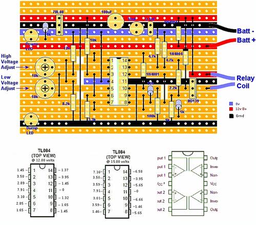

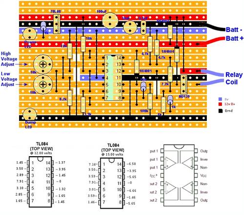

Here is a copy of my work graphic that I put together while building these controllers and comparing notes with Pete and others; maybe it will help.
Glenn check it over I make mistakes and I'm not good at graphics.

Check pins 1,2,3 again pin one looks too high to me, then if you are able to adjust the high and low pots with the supply you have you should be able to tweak it in when you get your variable supply built. I usually do the final adjustments after it is in its enclosure.
I tried to sharpen this graphic a bit, hope it uploads better..
