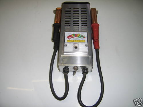

Is anyone out there able to tell me where i am able to buy a Battery Analyser meter with a voltage and amp load tester for low voltage like 2 volt not 12 or 6 volt so i am able to test my AGM and Gel deep cycle batteries or is it better to build my own similar to the picture shown.
regard Dwyer

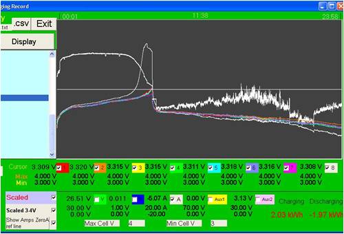

The in battery cell monitoring I use on my LiPo test battery can be used on PB-acid cells as well. With a suitable current sensor, you can get data like this.
The spikey line is the current, on a windy day. Recharge is above the horizontal line.
One cell, white, in a problem pack is easily identified.
Posted: 02:13pm 06 Mar 2010
I would think with a bit of tinkering you would be able to alter the meter shown, to read a FSD of around 2 volts.
Do you have a photo of the internals of the meter.

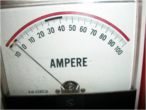

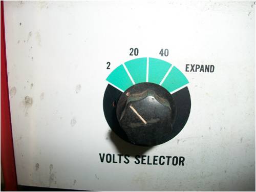

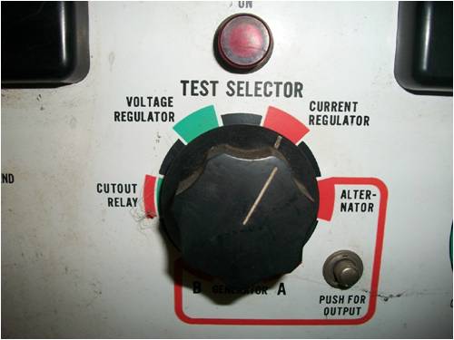

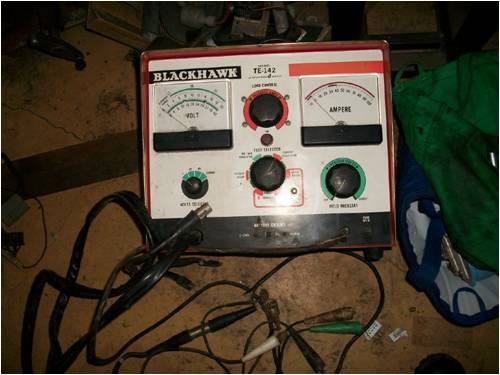

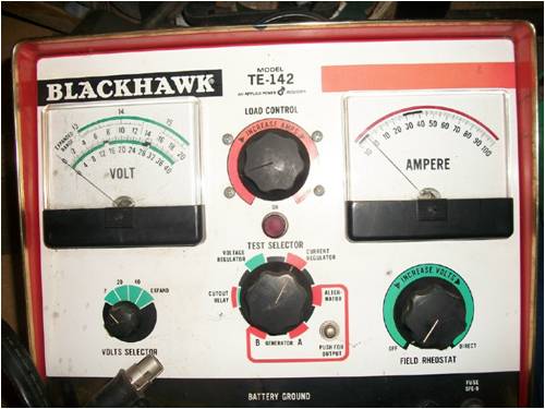

Just over month ago l brought Blackhawk batteries, Amp voltage tester from Tender Centre for $56 and since then, it has been sitting in my shed ever since and haven’t try to play with my ‘toy’ yet as I have been busy with other projects including working and hopefully I will test my batteries in few days time. However there is no workshop manual book and wonder if anyone has used this machine before as there is a lot of wires coming out with metal alligator clips and plugs.

Posted: 02:54pm 05 Jun 2010
that looks like a car/truck alternator/generator tester which should have a load resistor built in to it
