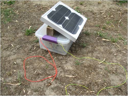

Hi I hope everyone is having a good break from the usual grind…
Here’s a few photo’s of the solar powered electric fence controller that I’ve built for the wife’s horses…
It has a 10W solar panel, a car ignition coil and the controller is based on a PIC16F690 with a software interface that has the following menus:

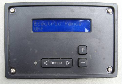

ELECTRIC FENCE
ON/OFF
POWER LEVEL
1>10
BATTERY VOLTAGE
xx.xxV
DISPLAY CONTRAST
1>10
The power level menu controls how long(dwell time) the ignition coil charges for and therefore the magnitude of the zap (!) it puts out
The coil is connected to the fence via a short length of car ignition cable that has approx 5k Ohm resistance.

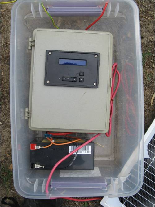

A $8 plastic storage crate makes the whole rig water resistant and portable, sure it might not last forever but it was a better option than a $120 pelican case
Inside the crate a 7.2Ah SLA battery and the controller with LCD interface.
A close up of the screen:

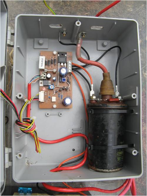

Inside the controller:

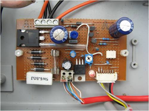

A close up of the circuit board:
The ignition coil is switched by a very large MOSFET that is snubbed by a string of 75V 5W zener diode and opto isolated for the microcontroller. The coil is separately fused incase something goes wrong.
The 10W solar panel charges the battery through a LM317 regulator that limits the voltage to 13.6V (float level)
The microcontroller samples the battery and turns off the electric fence if the battery voltage drops below approx 11v, this helps stop the battery from going too flat.
