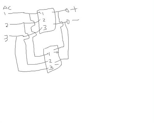

ok so i dont stuff it up
is it as simple as i have drawn (yes very quick a nasty)
thanks
Posted: 02:19pm 22 Dec 2009
Yes your drawing is correct BUT please take note of the other posting regarding the diode voltage drop differance that i neglected to mention.
