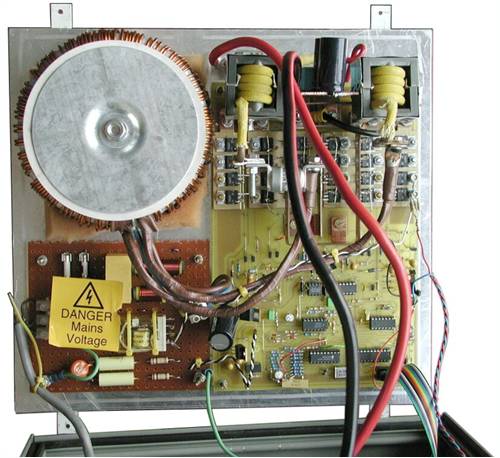

While looking for ideas and circuitry of a simple DIY induction heater, I came upon a site where someone also showed his Ph.D. work which included designing and building a simple grid-tied inverter (550W).
http://scopeboy.com/elec/RE/appendix-inverters3_3.pdf
taken from here: http://scopeboy.com/elec/RE/
All the info to build the design seems to be present, along with the source code for the PIC16F84.
Thought it might interest the odd person here, now or in the future, as we regularly get questions about 'simple' DIY grid tied inverters. This is the first one I see that looks actually DIY-able to me.
Peter. (<-- not interested in the legal aspects of such a project)

Hi Dinges,
The complexity of this GTI does not seem to be as great as the SMA, Fronius, type units, but this unit is similar in component count to a Latronics PVE1200. The price of commercial units is continually falling, so buying one is still probably the way to go. Making your own gives a repair option if it does goes wrong. The legal aspects would not matter too much in an AC coupled OFF grid application, like I mentioned on another thread, with the cheaper, Chinese manufactured units now available on EBay.
