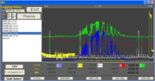

This is a plot of data I logged with a program I have written to decode the output from one of these CurrentCost meters. This shows SolarRE and house power and offpeak power and a net import/export and outside temperature.
There is a lot more that can be decoded. I have just shown real time power logging, but recording of kWhr etc is possible.
You can notice the effect of clouds on the solarRE, and the fridge and freezer operation, etc.

Hi Gordon! You have done a fantastic job in writing this
Visual Basic software. The software that is available on
the web from the manufacturer's site is very poor. Most
impressive with your software is that you are able to
display the data graphically from 3 separate clamp
sensors. The original software simply adds the 3 clamps
values into one recorded value.

I made this logging program in response to a lack of response from the manufacturer of the smart meter used by ETSA in SA for import export measurement. I wanted to see how my RE efforts played a part in day to day power usage in my home.
The CurrentCost power meter has the CE and UL certificates, so connections in the meter box are not much problem with the clamp sensors. I have an older meterbox, so there is more space behind the fuses.
I can pretty much do any calculations now I have access to the raw data. I store the data as daily files at present. I am looking at making some more files for accumulated kWhr. As I make more observations, more options come to mind.
The Solar Schools program is apparently looking for a logging option, and this unit would go a long way towards providing this. The mixing of Export and import power readings at 10sec intervals with recording options is a powerful education tool. There would be possibility of collation of all this data in a combined database. The data format is presently in XML type format, or CSV. Web based monitoring becomes an available option, similar to what is done with weather data.
