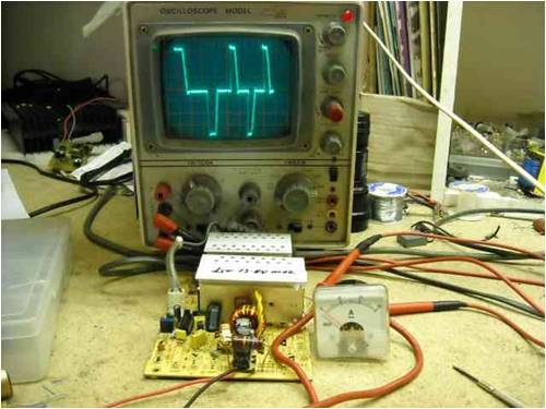

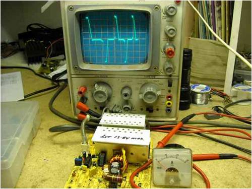

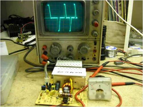

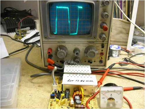

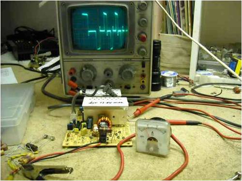

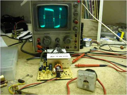

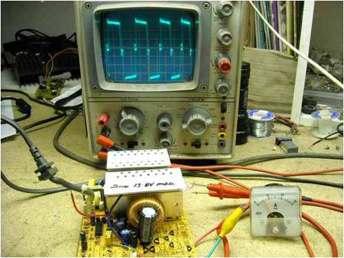

Ok, here are the piks you needed to see
Here is the unmessed with supply with very little load ... ie less than 15W Notice it is not a square wave, and it gets worse with less load until it is just a mess. From this point on (more load), it turns into square wave. The interesting thing is that the drive wave from the chip is square, but the output from the totems is not......
It seems that as the output voltage is at set level anyway (capacitors keep it there against low drain), the pulse starts out well, but loses something in the totems... don't understand this.

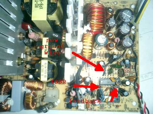

At this point I played with your first conversion, and decided that as I had no decent safe loads to drive ( I always use a very low impedance motor... which would blow this up), I would butcher this one completely.
I pulled off everything on the low side except for the 494 and associated bits..... this included the voltage stabilization stuff for the aux supply.... It now looks like this.... notice the current limiting is in place as well to protect it from me. This is the first one I have played with that has an opto for the aux. By ripping out the opto, and placing a 270R resistor where it's high side pins were, we get a steady 15v for the 494.... but no 5v supply for you to use ... I wanted to have no feedback interference to worry about.
I replaced the inductor with a larger one while I was there, and used smaller caps on the output to give me more room to play. The current sense is as the circuit but with 330r 10n feedback not the 470n.

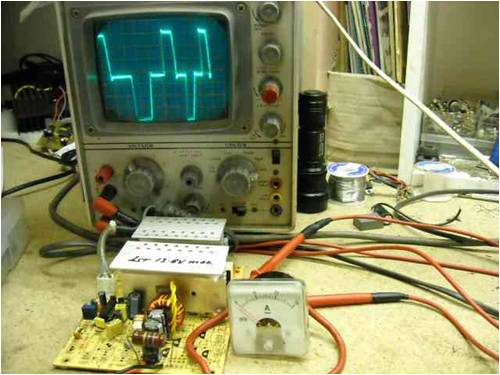

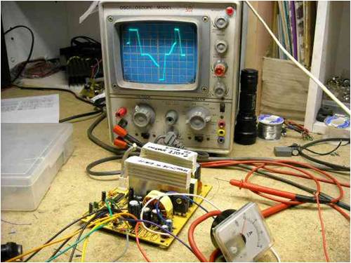

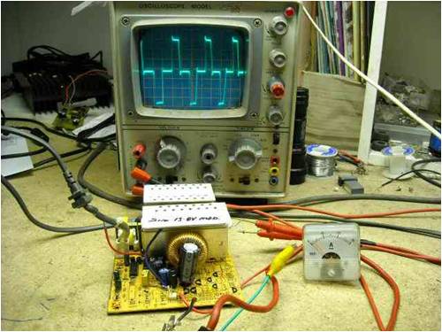

At 7v almost 0 amps.. the wave form is just as sorry as the original.....:
The good news is that as we wind up the voltage to 10v it looks like this... still less than 15W... so don't panic.
As we get to about 20W, we start to see a more normal type of wave. You must forgive the assymetrical stretch and upper and lower size... this scope is 30 years old... and is not even remotly accurate... but it gives me a good enough idea of what I'm looking for. It rises steeply, and drops off at an angle.. I think this is real.. but it could be the stretching in the scope.
At 25v and >1A (maybe 30W) it looks like this .... note the stretching across the screen...
and at 30v maybe 60W, it's like this:
and peaked out is like this:

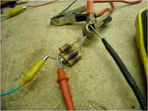

So if we use voltage control only on a high impedance load (about 10R) it looks like that.

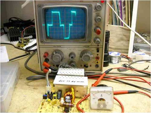

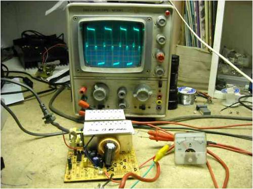

Now for the fun stuff, with the vac motor connected (maybe an ohm or so) and set down at about 5A and 7V (35W).
At 7A and 14v (100W) it looks like this:
If we pull the current and volts up to 260W 26v@10A then it gets to look like this:
and >300W (30v@12A)looks to be the end of this with the present settings.....

It was good to see that this supply had two wires joining the centertap to the earth point. I snipped one out and used the remaining one as the current shunt.

"You probably noticed how quickly the sinks heated with the original sloppy wave. How did they compare once you fixed the aux supply to 15V? "
I didn't really look at the first supply in operation, other than to see that it worked (no blown trannies etc).
As I had two conversions, I decided to lay waste to this one as if I was starting from scratch... That way I would not follow any problems that I had not noticed, and would prove to me that it would do as I said it should.... and it did.
The first photo was of your unmodified unit... original condition, just to show that under less than 15w, the original was no good either... but obviously improved with load very nicely.
I'm not sure that the 15v was instrumental to the improvements, but was part of the rebuild... I just like a bit more voltage... just me. I wanted to make sure I had no interferring fluctuations which may have been from the regulation of the aux.... so thats why I ditched the opto system... and it gave me an empty board on the LV side.

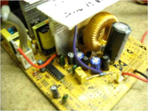

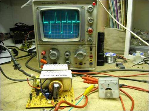

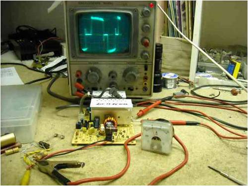

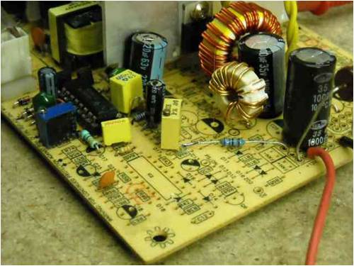

Well, I grabbed a former toroid with about 35 turns on it, and replaced the inductor, and the caps (too low voltage you had on there... one is now in orbit). Actually I only used 1 cap, and didn't bother with the second one (on the output itself).
It is exactly as you sent it. (#2).The only change is the inductor and the cap. (1000uf 63v)... so no real difference except the voltage and smaller uf.... and the 2 pin plug thing.

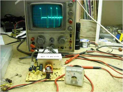

It looks like this:
Now...( with impish grin), your gonna kick yourself when you look at these pics......
Here we are at 7W .........7V7 @ 1A
and at 20W ...... 10V7 @ 2A
at around 100W ... 20v 5A
and 120w
So go and do a conversion, and wind different inductors... it will solve your problems.

It actually came about from the discussion we were involved in regarding power/crest factor when charging a battery or driving the front end of PWM units. Strangely and looking at it now, the inductor you spoke of seems to fit in here.... which I only just realised as I typed this . If I were a bit brighter I should have realised earlier .... but I got some chocky chip cookies and good coffee for being a bit slow .... and a few nice power supplies... thanks Spud.
Now, Spud, If you want to straighten up the trailing edge of the "square wave" shown best in the 7 watt photo (see it's even better than the original supply down at these levels too )...
Simply replace the damping capacitor and resistor (103 capacitor and 10ohm resistor in series across the secondary) with a 47R and a 1n capacitor. This will result in a near perfect sided square wave, and run a bit cooler too.... seems to run ok all the way up to 120w. Will see when the current control is in place if it affects the upper end (300W+) or not... it won't get rid of that little "spike" at the top of the leading and trailing edge though.
I couldn't take this supply any higher in power... as my resistor bank started cooking quite nicely at 120W. When I put the current limit circuit on, I will be able to drive it to full>300W and see the heating. It ran maybe 45 degrees C up at the 120W mark ....although 3-4 min was as much smoke as I could stand from the resistor bank though.
So we didn't just equal the waveform of the original supply down low, but I think easily bettered it

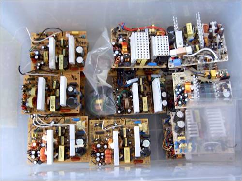

I stripped down a carton of PSUs the other day, and filed them in a plastic container. I shall select a victim and proceed.
I'm grateful as always and hope as a non-coffee drinker I choose something to your taste especially for these chilly nights.

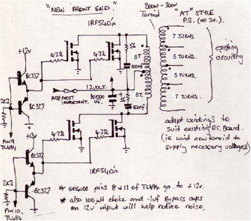

Stumbled upon the link below the other day. Someone has developed a very simple conversion for PC PSUs, to drive them with 12Vdc input (instead of 230Vac). This method should work too for 24 and 48Vdc input power:
http://www.dasilvas.info/ATX%20Power%20supply.htm
Basically, he takes out the entire input section, including transformer. Rewinds the transformer (or simply takes a large toroid he wound) and adds low-voltage/high-current switchers (IRF540 MOSFETs), driven directly by the outputs of the TL494 via totem-pole drivers.
Haven't tried this out myself yet, but intend to do so when time allows. Can't get much simpler than this.
Could also be turned into a simple boost-converter for windturbines, perhaps? Input 12V, output 24V (on the 12V line), or even 48V by cutting the groundlead of the secondary and full-wave rectifying the + and - 12V lines (yielding 2*24V).
The only limit with those PSUs seems to be one's imagination....

Neat. I assume the input and output sides share common grounds. It needs another * note. The 494 will need bootstrapping as it no longer has the unstable front end to trickle start the secondary for the Vcc for the 494
Or simply put, 12v to pins 8 (collector 1),11(collector 2). and 12 (vcc)
After startup, vcc can come from the output if you wish, and the rectifying diode will isolate the 12v proper.(though I would just use the 12v and cut the power from the secondary system anyway)
I don't see the totem poles acting as a multivibrator to get startup....so no bootstrap.. but I've been wrong before too.

He basically feeds the TL494 straight from input power - no bootstrapping required. And yes, downside is that there's no galvanic separation between inputs and outputs as ground is shared. I'd also remove the components on the secondary side that normally power the TL494 after startup, as you suggested.
If galvanic separation were a requirement, I'd probably feed the TL494 straight from its own small DC-DC power converter (with floating output ground). That way you get the total galvanic separation on input and output, and no bootstrapping required. A simple DC-DC brick module would be all it takes.

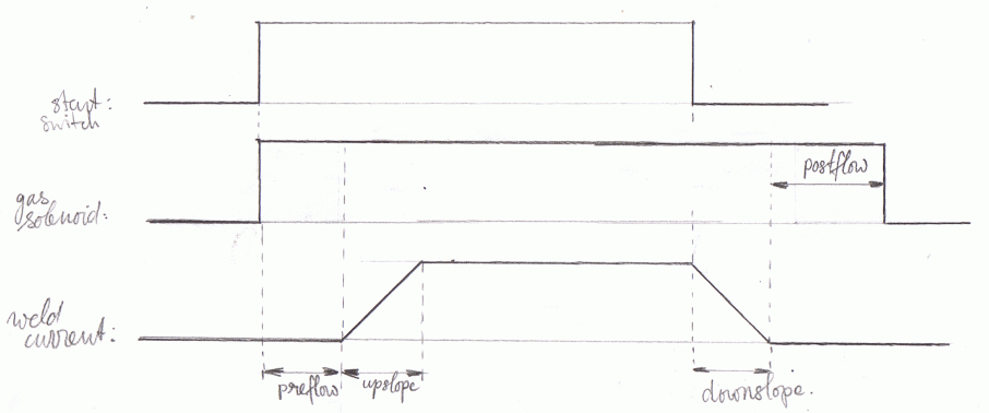

Anyway, my question to you: if using a PC PSU, how would you incorporate up-slope/down-slope. I.e., assume that we have set a current of 5A using the normal method via the Oztules' current modification. Now, when the weld is to be started, the current is to be ramped up from 0A to 5A over a user-determined time (from about .5-3s with a user-adjustable timer; same for down-slope at the end of the weld). I've been pondering how to do this ramping up and down, either by injecting a signal in the current opamp in the TL494, or via the dead-time control (DTC), pin4 of the TL494.
Thinking aloud here and interested in your opinion on the matter of modulating current of a PC PSU. How would you go about it?

Hmmm, I'm inclined at first blush to leave the V and A circuits alone, and use the pin 4 route.
A simple 5v+ through a resistor (time 1) to drive pin4 (and a capacitor to ground for timing) will hold it high (off). Perhaps through the contacts of a NC relay, and when you press the trigger, the NO contacts of the relay short the pin4 to ground through a resistance (time2) (on).
So a double throw, single pole where the common is to pin4 and the nc and no contacts to +5v and gnd respectively through your timing resistors... and a cap on pin4 for the timing.
This will pull it down softly to full on (zero pin 4) when you pull the trigger to go.

Oztules, had an already modified PC PSU lying in the attic which I had modified in the past for variable voltage and a current limit of 13A. When supplying a variable voltage (by a potentiometer) of between 0 and Vref, output voltage can be nicely controlled between minimum and maximum (2.5-28V). Works very nice. But when I short the outputs of the PSU and try to modulate current, there's no real control - below a certain setting of the potmeter, current is zero, and the slightest bit above the threshold current goes to maximum (13A). It can't really be controlled with the deadtime voltage. Strange, but one thing is that I didn't modify the current control properly, as this PSU didn't have a 'flying lead' at the transformer. Not sure exactly *what* I did back then, but I'll modify it to 'standard Oztules' configuration and try again. Current should be properly variable, just like voltage, me thinks.

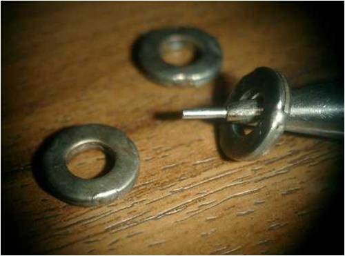

2 stainless M3 rings, welded together with 3 tiny TIG spotwelds. A continuous bead along the side wasn't possible as the work overheated, and I couldn't turn current down anymore on this large machine (250A watercooled) - when the arc was struck, it immediately had to be extinguished again. My idea is to build a small machine that performs well in the 0.5-5A range, and may go up to 10A.
Machines like this are commercially available and basically nothing more than a constant-current source PSU with a solenoid valve for gasflow and a bit of control.

Magic smoke.... I guess your sense resistance was miniscule to almost non-existent. Use a larger R in the center tap leg. This should give you much more definition, and a chance for the deadtime to have some control.
The smoke means that probably noise was the signal that the current sense comparator was using as a reference for your current control....living on the edge I suspect.
I remember marveling at the shortness of your "link" resistance when you mentioned it originally. I'm beginning to think that your current limiting in that case was more good luck than good management

[quote]I guess your sense resistance was miniscule to almost non-existent. Use a larger R in the center tap leg.[/quote]
Guess again. :-)
The sense resistance is small, but current control worked perfectly, at least at high currents (12-13A). Had set it with a fixed value (180R feedback resistor instead of 2k pot) to 13A. As sense resistor, I used the PCB trace....you can see a thin black wire from where the ground lead leaves the print to the TL494. That provides the ground signal for pin 16. The negative feedback from the sense resistor (i.e. PCB trace in this case) is taken directly at the common-pins of the transformer. No extra wires needed, all I did was create a new ground level signal by adding a black wire from the output ground to pin 16 of the TL494, see image below.
But this morning as I got out of bed the problem hit me.... I had opened the 180R feedback resistor and inserted a resistance decade to play around with the feedback value a bit. Now, when I built this decade a few years ago I *specifically* wanted break-before-make switches in it.
(the little clown, he cheers me up when I'm down)
Well, when I shorted the output and plugged the PSU in, I briefly measured 20A so I swiftly reduced resistance by lowering the resistance of the decade. I guess you can guess what happened as I switched resistors... the feedback loop was briefly opened (break-before-make....), with described results. PSU fuse blew and house-breaker tripped. Switcher transistors had magically converted themselves into small-value resistors, but two exact replacements (2SC2625) were found in the parts bin. Felt a bit like a surgeon doing a donor organ transplant, inserting bits from a deceased (and long since gutted for parts) PSU into the patient on my work desk.
But you're right, I'll increase the value of the sense resistor and a potmeter to make current user-adjustable down to a few 100 mA.
