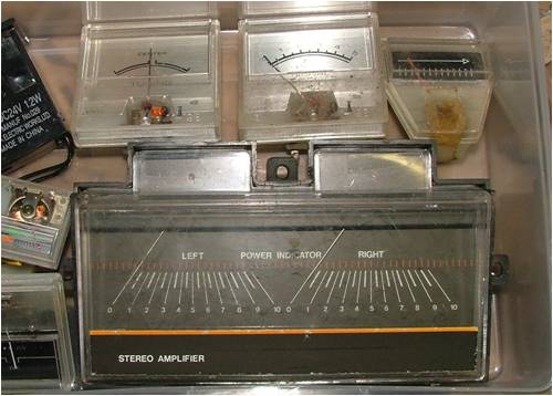

I've been cleaning up my junk pile and sorting everything into draws of components. I have a few meters from old stereo's and tuners.
So its time to put together a project I've been meaning to do for years, a expanded scale volt meter for my battery bank. And I'll write it up as a page for the web site, as I think its a project that might interest others. This will be both a volt meter and amp meter side by side, the volt meter will be 10 to 15 volts, and the amp meter will be center zero, so will measure draw and charge.
