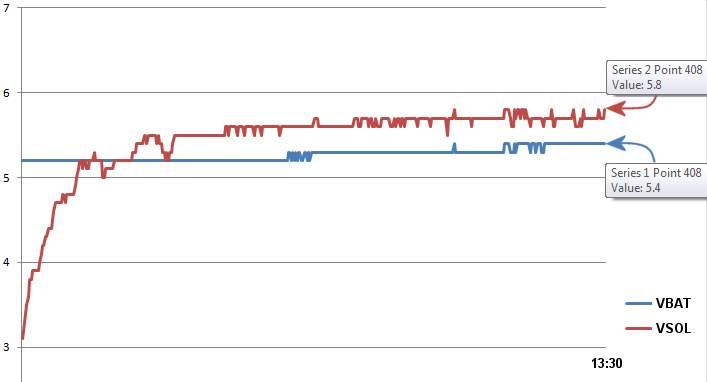

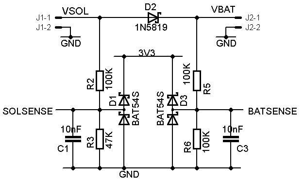

Battery voltage drops to about 5.2V overnight but as the sun comes up, in today's blustery weather with bright bits, VBAT comes up as usual to about 5.4V with VSOL occasionally hitting 5.8V. I sense both solar and battery voltages through potential dividers with D1 and D3 clamping anything nasty to the supply rails and then onto AIN pins, applying a multiplier in the prog to give "real" voltages. All works nicely, but we are coming up to maximum daylight and I am wondering about six months from now when we might be lucky to get 8 hours of heavy overcast.
I am conscious of the voltage drop across D2 and sure enough the trend shows the expected 0.3v-ish difference between VSOL and VBAT (of course VSOL will be dragged down towards VBAT as it tends to short circuit). Clearly this is very blunt and I don't have space or $$$ for some MPPT controller (hence NiMh cells which are quite forgiving).

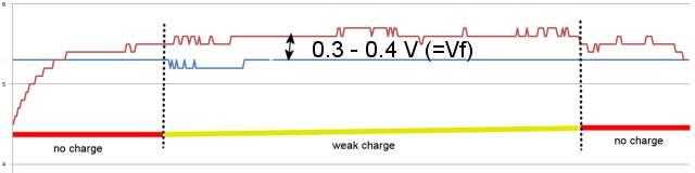

so I have been prattling on about the Vf of my chosen Schottky barrier diode in my solar charging circuit (see above)
I tried @phil99's idea of a bigger diode (thanks for that) so as to take advantage of it's gentler conduction curve and it was better but with both 10A and 20A variants, Vf was still around 300mV
you can see my dilemma here - was a fairly bright start to the day but now is very gloomy with rain on the way (trace ends at about 2PM, so very dull afternoon).
everything with those red lines and VSol>VBat could be putting a weak charge in to the battery.

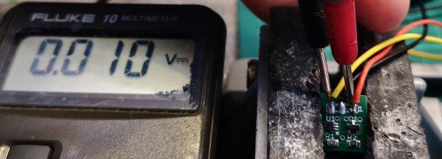

So I got some cute little boards made up for the four component Ideal Diode and assembled/tested one this lunchtime.
Tests I had already done with what I had, suggested I might get Vf down to about 50mV which was very desireable... but, errrr...
Vf=10mV! with the diode into a 56Ω load at 6V (i.e. to draw ~100mA) which are the maximum characteristics of the little solar panel I am using (which I won't get in reality).
So, the question is: "how much 'ideal' is too much?" and what issues do you guys see if I put this in parallel with D2 (easier than replacing)?

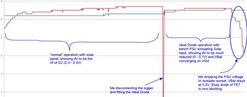

Last words on this - probably.
I went ahead and got the logger into the shed and fitted the Ideal Diode circuit board across D2. Below is the trace for the day (almost). The circuit runs as expected and the traces look very healthy.
Next step is to load the new software and put it back in the wild... which will be tomorrow so I can continue to monitor batter use over night.
