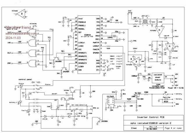

Here is the EG8010 schematic, voltage feedback is located in the top right corner.
Any suggestions as to why that poor regulation are welcome.

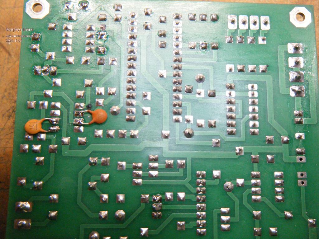

Klaus try putting a 47p - 100p capacitor - with relatively short leads less than 10mm long between pins 5 & 6 of opamp A and retest. If problem is still present add another 47-100p between pins 2 & 3 of opamp A and retest. Hopefully one or both may do the trick. Did you use a ground-plane on the PCB ? Noise pick up on pin 6 & pin 3 of the A opamp is fairly sensitive to long traces or and no ground-plane. Good luck !
Cheers Mike

I did try wiseguy's capacitor suggestion today, no joy, if anything it made the regulation worse (down to 195V with the same load).
I shall try measuring the Vfb as poida suggested tomorrow. Meanwhile here are some more details:
The PCB has a ground plane on the component side. The AC voltage is sensed at the toroid winding connection, before any filtering.

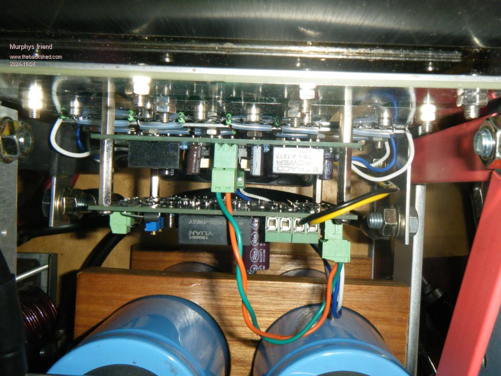

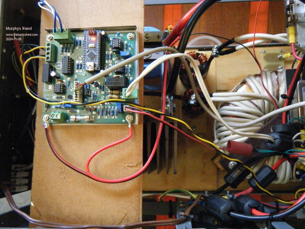

And here is how it is located:
Looking down into the inverter, on top of the picture is the heatsink with the power board attached. The driver board is piggy backed onto this with short spacers and the control board on top of that on longer spacers.

The only problem I perceive is as I described initially, noise pick upon your first "A" opamp.
  Murphy's friend said  I did try wiseguy's capacitor suggestion today, no joy, if anything it made the regulation worse (down to 195V with the same load)
To my mind this also reinforces that we are in the right area for the right reasons but with the wrong cure tried first, causing the issue to be worse.
I thought adding the capacitors might help, instead of having to add a faraday screen.
That is a piece of Aluminium plate between the Power drive board and the controller PCB/s. Dex had exactly the same issue with his inverter and it was solved 100% with the screen. The capacitor was an untested guess which should have helped for filtering fast witching spikes (in theory...). 4 more 10mm hex spacers and a metal plate is all thats needed.
I have looked at your schematic and I think there may be an issue with the link on the corner of the PCB with the ferrite bead, which appears to be the battery negative power supply return wire for the PCB. I normally connect the battery feed wire via a single connector pin direct to the ground plane. If you put a sheet metal screen plate under the PCB the Ferrite bead needs to go! The ground plane of the PCB must be solidly coupled to the metal screen plate, the bead places HF impedance between the two. If it has to remain as the battery connection just use a wire link without a bead. I would choose to place a 10nF MLCC capacitor instead of the link, and supply controller power via the -55V node shown on the schematic or other similar connection to the ground-plane.
The schematic shows what appears to be a +/- 55V source to something else which is for what ? Best practice is to power external stuff directly not via the PCB. I always have only the one DC coupled negative connection to the battery minus for the controller and that would be at the point that the Battery negative connects to the chassis or to the Power PCB negative point. Its only function is for the miniscule power the controller needs and as a return sense wire for the battery voltage measurement.
Another good thing to do with floating Cmos nodes in a dual opamp in a noisy environment is to tie them somewhere. I would tie pins 6 & 7 together on the unused "B" opamp and ground pin 5 so its function is as a voltage follower which is now referenced to ground.
The reason why your other inverters did not have this problem as I perceive it is because they did not use an active amplifier/rectifier in the feedback path, which does have some nodes that would be sensitive to noise. Some copper foil a bit bigger than a larger postage stamp and soldered to a couple of ground points covering the sensitive nodes & traces might sort the problem out without making a full metalwork shield. - I never envisaged that a controller board would be placed/bolted in such close proximity to the power section in a build.
The fact the feedback voltage is rock steady I submit means the feedback voltage & servo loop is operating perfectly. If the output volts are falling but the feedback is fine and rock steady at 2.76V that is because noise is being picked up by the Opamp "A" on your PCB and added to the feedback signal. As it is now artificially at 2.76 due to feedback + noise injection then the PWM reduced the output voltage so output voltage + noise was equal to 2.76V. Simple huh ?
