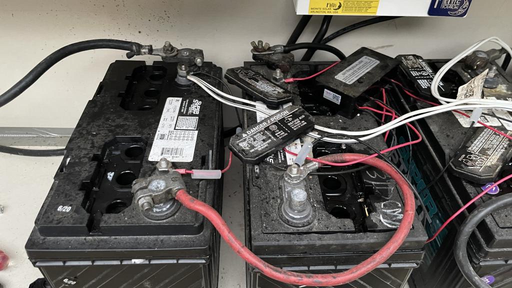

When I visited my site a while back, we found a catastrophic situation at-hand. I am unsure of the sequence of events or what caused it for sure, but the end result was 4 blown batteries, a shorted FET on the MPPT, a fried Xantrex 4kW inverter and battery acid in my power closet.
In the summer, my power closet faces the sun. In the afternoons, it get quite toasted for hours in direct sunlight, but it is (normally) well insulated and cool inside. When we got there this time though,the doors were wide open for what might have been weeks. This exposes my (black) deep-cycle batteries to the sun, and I'm sure they could easily get extremely overheated.
Here's what they looked like:
The valves are literally blown off the left-most battery, and you can see acid splatters on the wall behind it. According to my dad, on the other two batteries visible the valves didn't blow completely off but were loose, as if they had just barely popped.

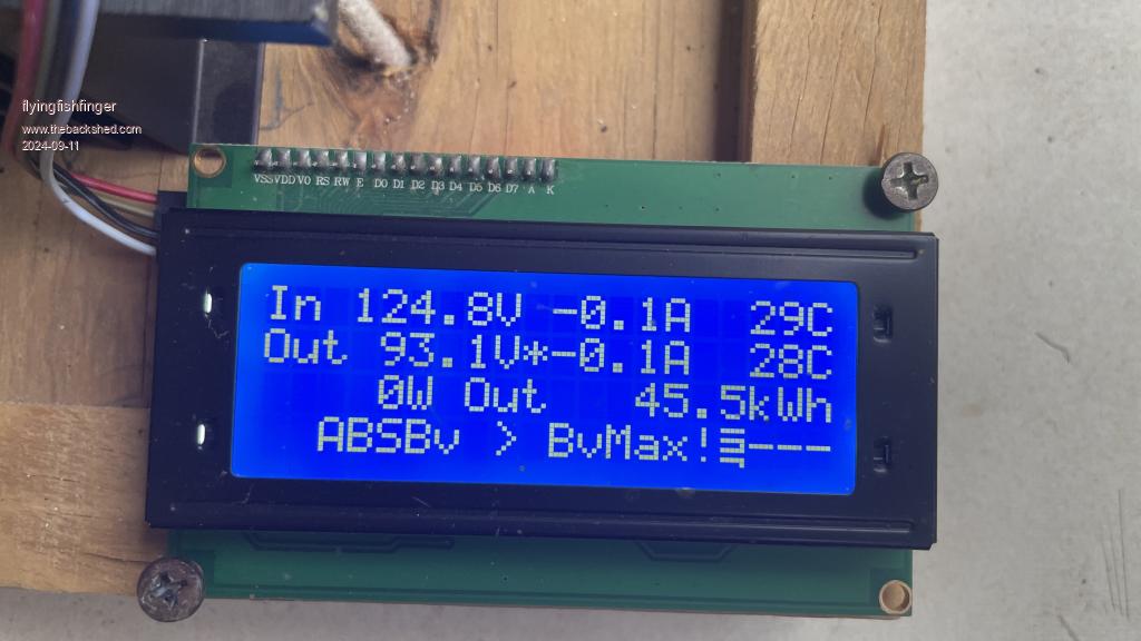

My solar array puts out about 127V at MPPT. When we arrived, this is what we saw on the screen:
The way I read this is that the batteries are totally overcharged / destroyed and hanging out at 90V, and because I found a blown FET on the MPPT the input is connected directly to the output.
My dad didn't know this, and since we had no cell network at the time he flipped on my inverter without checking....BOOM.
That's my best reading of the sequence of events, although I can't say whether the FETs fried first, overcharged the batteries, blew the valves, or if the heat boiled the batteries and made their resistance so high that the voltage shot up, and that popped the FET. That's my first question...

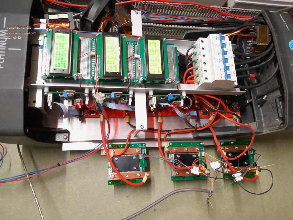

nickskethisniks
Joined: 17/10/2017
Location: Belgium
Posts: 499
Posted: 07:30pm 11 Sep 2024
Unfortunately you were not the first to experience this problem.
You could see it as a flaw or lack of feature in this case, so there is a need for extra external protection layer.
Lot of work was done to make this a very robust controller (my first controller was put in service end 2019 without problems) but under other circumstances, very high currents, up to 80-100A for longer periods but much less voltage ( <75V). I think this higher voltage you and others use might not been tested enough (with tested I mean a complete analysis like poida did with an oscilloscope and stuf, but important it was done with certain silicon and with lower voltages). Allthough I'm convinced this is perfectly usable with higher voltage panels.
The controller is now on a smaller array since I went for newer panels and choose to build a triple controller. I had a big contactor that could disconnect the dc but I could not use it for 3 different arrays. It consumed at least 5-10W and did not want to tripple that, those are also expensive so I came up with something different, but not cheap either.
I use mosfets to disconnect each solar string, a few mosfets parallel and in antiseries, so it could disconnect DC bidirectional without lot of energy loss.
They are controlled by a 24V signal comming from my domotics system, but could be controlled by a simple opamp or arduino sensing the voltage.
(I do not know why the pictures are not the way I want...)
Edited 2024-09-12 05:39 by nickskethisniks

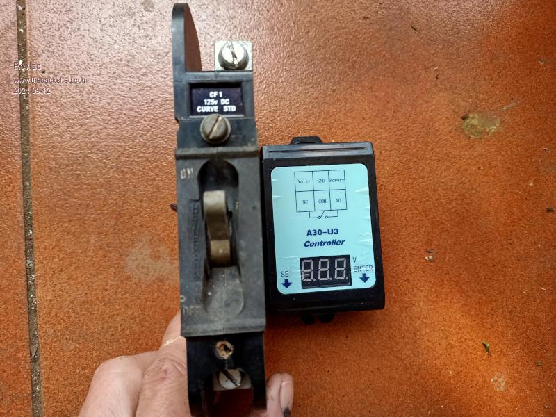

I was looking at a Shunt Trip release, however most of them are for AC circuit tripping, but the I like way it works.
What I'm thinking, I have one of those A30 controllers for over voltage detection etc, and Have an old DC rated 65A circuit breaker from a battery charger that can be connected to the solar charger input, it has a small hole in the top of the switch leaver so a wire can be inserted, I could use a solenoid to pull the breaker to off position, when battery over voltage is detected by the controller and this will cut off the solar input to the charge controller, its a bit agricultural, and mechanical but should be reliable , there is more to this just haven't worked it all out yet.

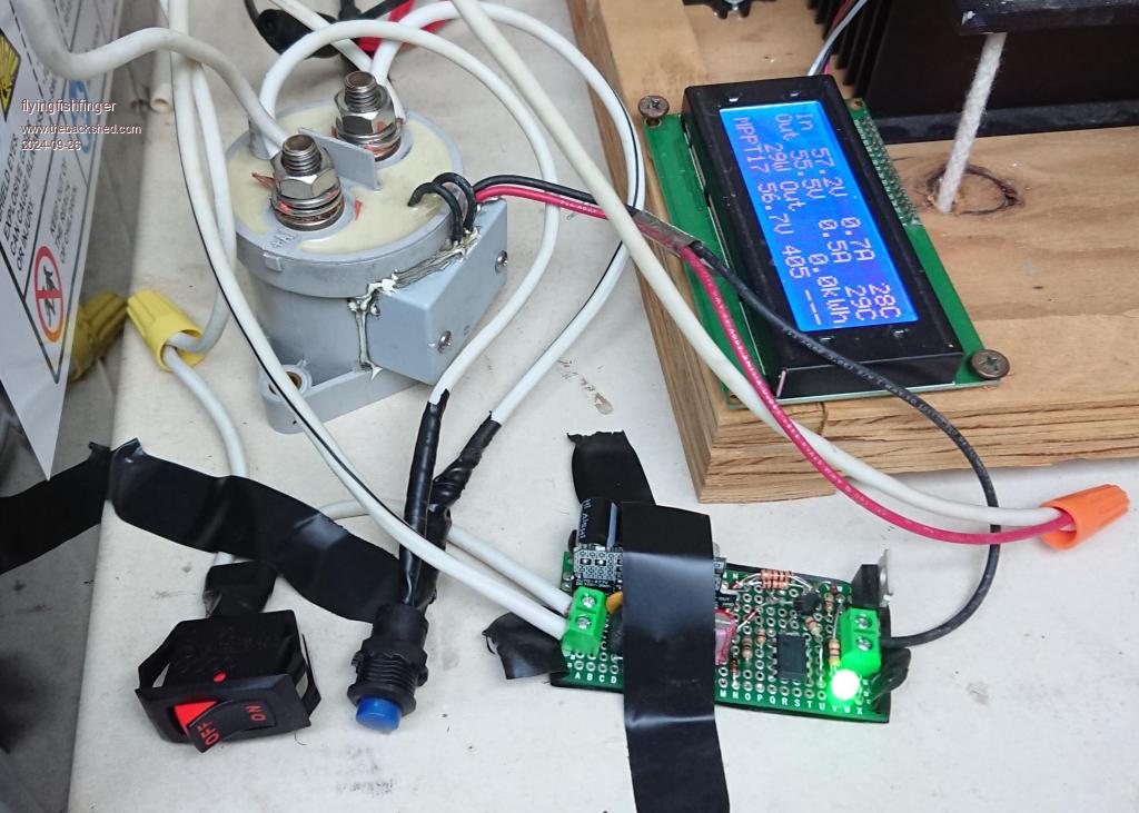

Built and tested a very hacky, hand-assembled version of Dex's circuit with a contactor and pre-charge. I'll put it in a nicer panel later, but I think it works ok!
Late afternoon, fully shaded by trees so not much power happening.
Thanks for the thoughts!
