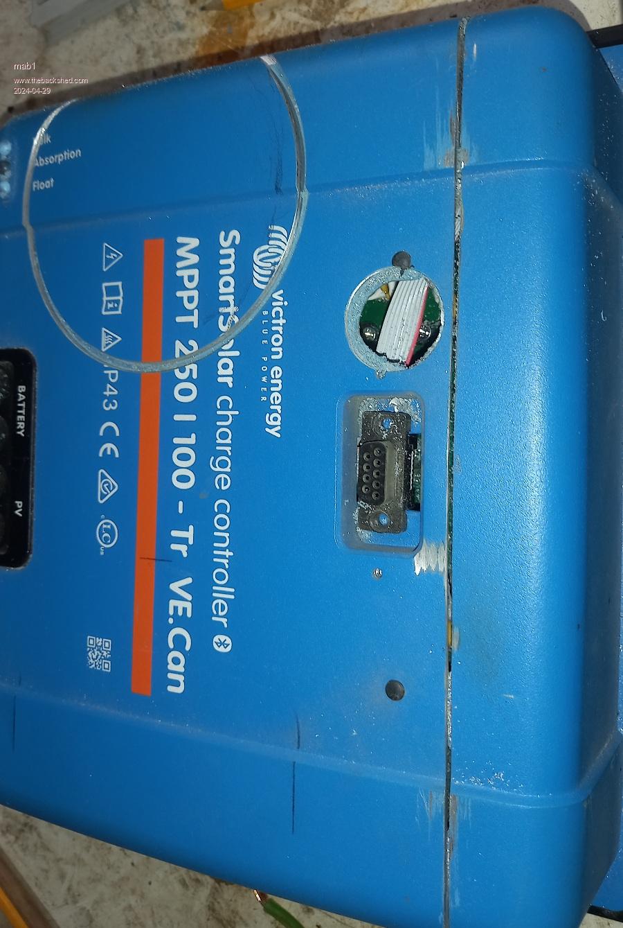

My neighbour has given me a challenge: his very expensive 250V 100A mppt controller went dead pretty much on its 2nd birthday, and my mission is to resurrect it. To be fair to it, the neighbour is using a 6 panel array Voc 230v into a 12V battery , so he was pushing it to its limits. If i should succeed, i might suggest he split the pv array into a 3s2p config - it's only a few yards from the battery.
It's dead and theres 0.6v on the pv input - it's shorting the panels.

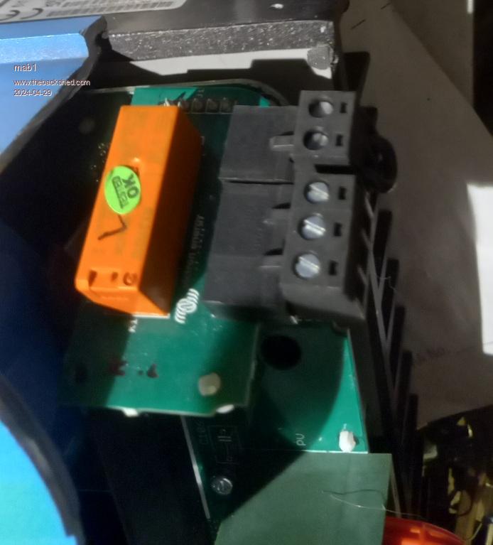

I remembered someone on here pointing out they're not made to open up easily, so following a bit of google/U-tube - ing i started in with an angle grinder and a hole cutter in the pillar drill.

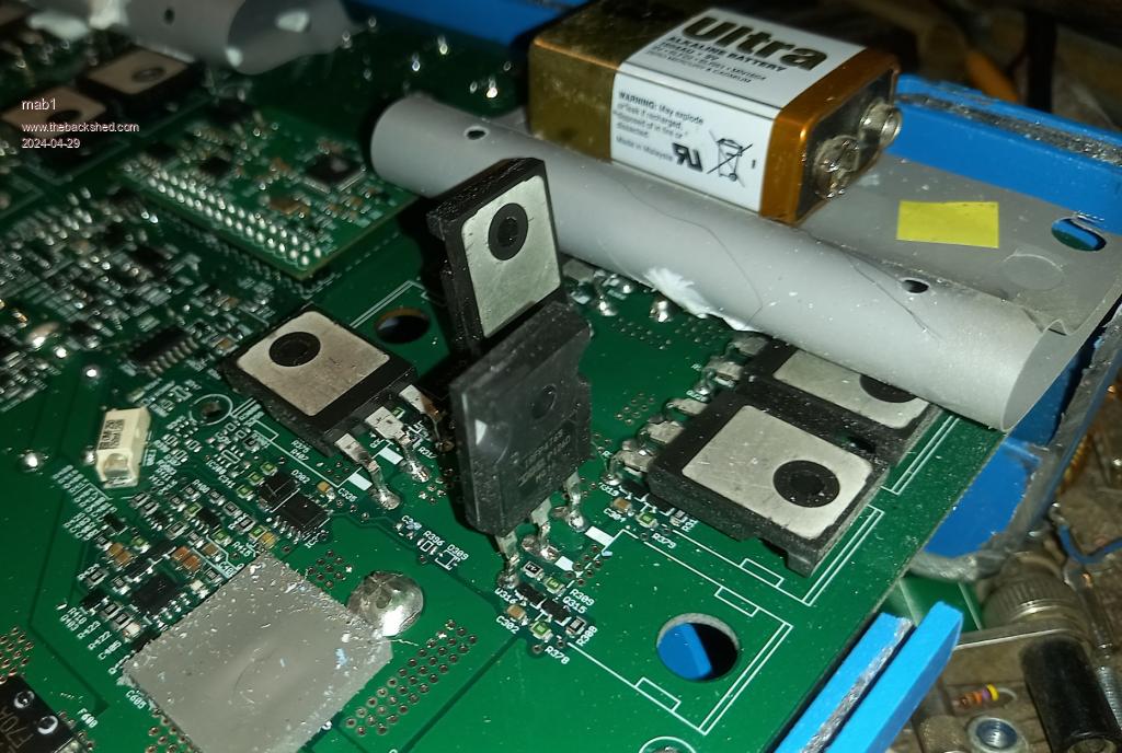

So far so good - i cut the one inch hole to see in enough to be sure i missed the inductors and caps.

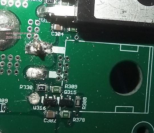

Once i got it open and off the heatsink i found that the two 70A fuses on the battery side were blown. There are three fets on the pv input (hopefully ok, as two of them are £15 a pop), and there are six FETS on each side: the six on the left check out ok with a diode tester, the six on the right are shorted.
The FETS are IRFP4768
The two that I've bent up have shorted gates so i removed them two - the other 4 appear to be OK with the diode test once they shorted two are gone. Then soldered wire links in place of the fuses.

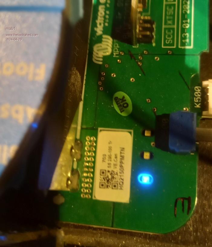

Then try connecting a 12v bench supply to the battery input:
It lives! The LEDs flash and settled to flashing the bulk LED every 3 secs (standby).

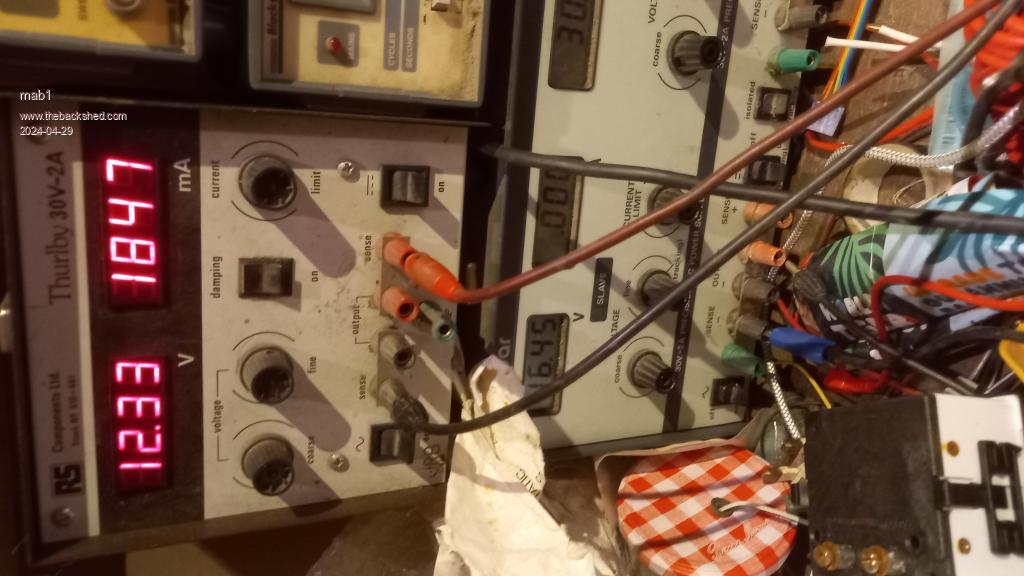

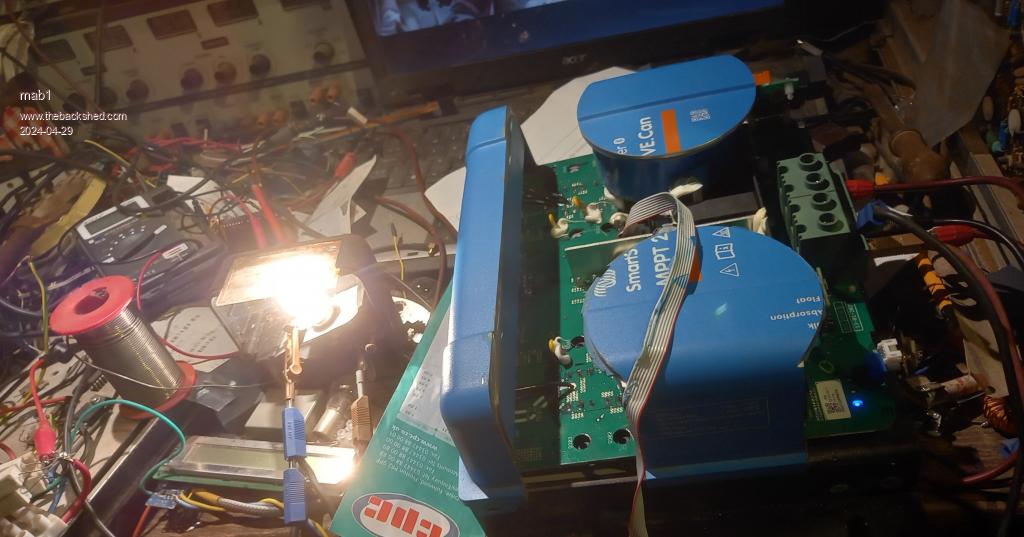

So to  see if it will actually work i connected a 21w lamp to the battery terminals (the bench psu won't take charge of course), and a 2nd  bench psu to the pv input.
Sorry, the workbench is a bit cluttered

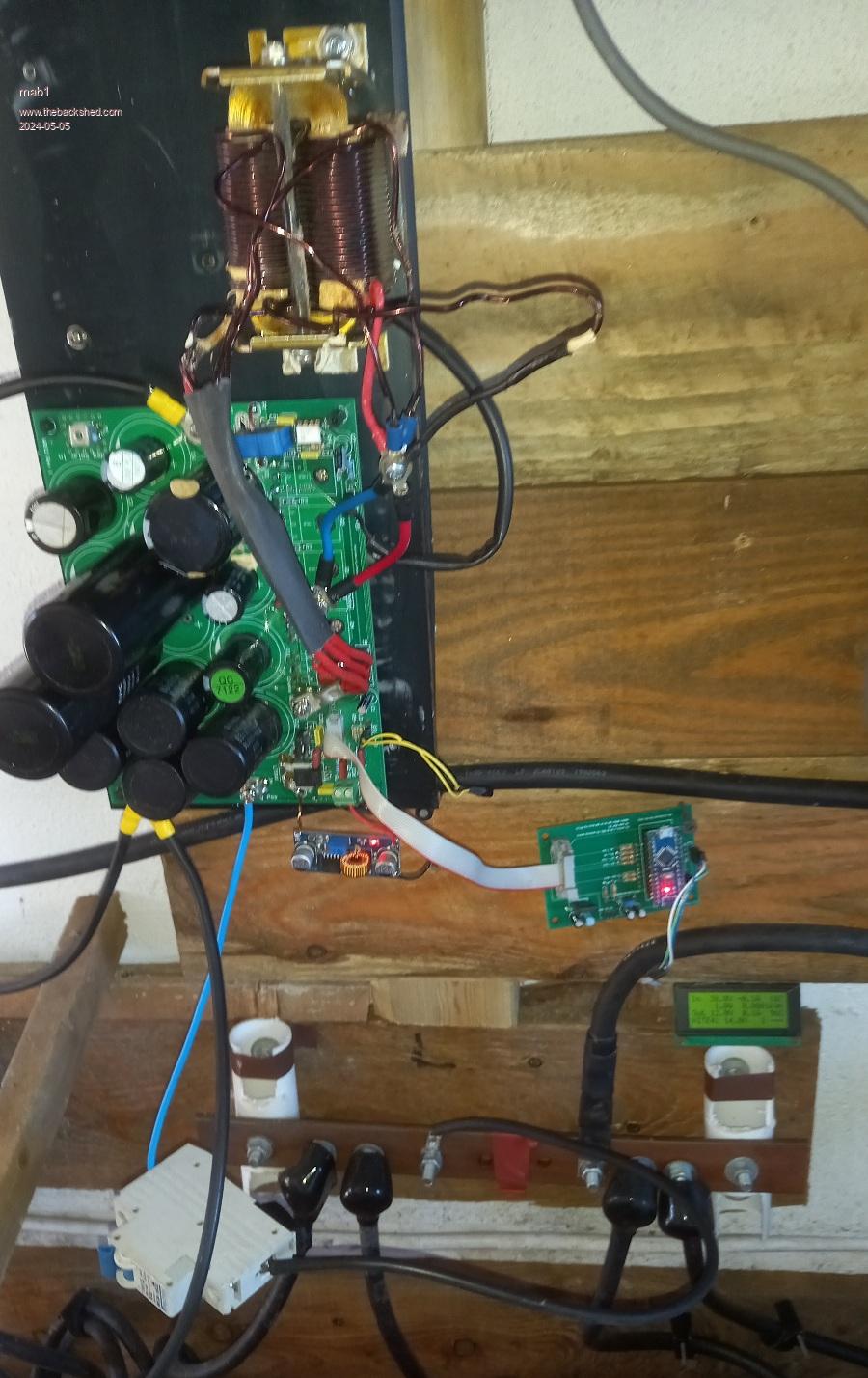

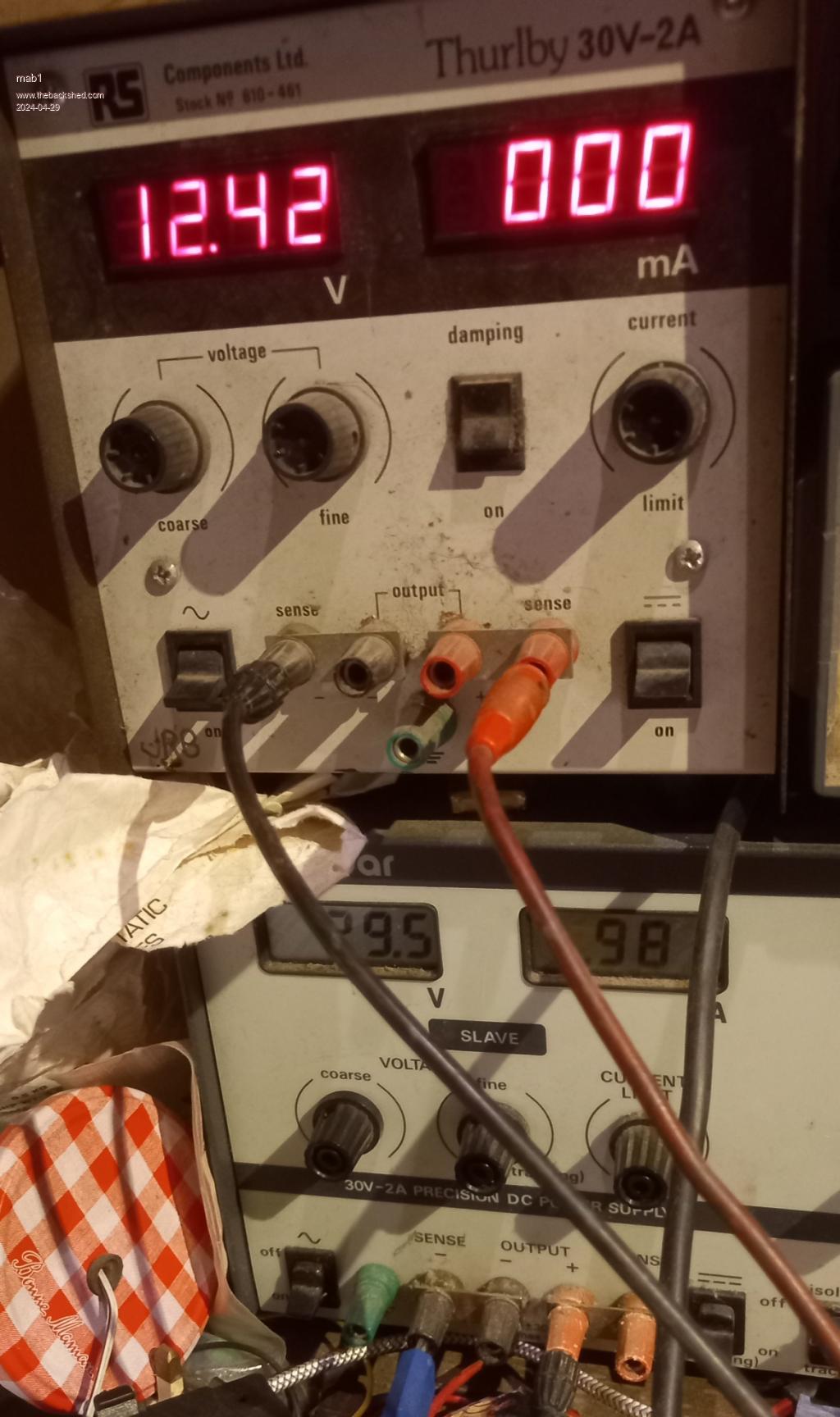

I then spent an hour trying to work out why it wouldn't wake up with 30v or even 60v on its input - then remempered there had been a plug with a link in the 'remote' socket.
Well, bu**er me! It's working

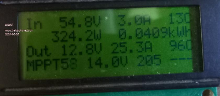

This is the current draw for the 21w lamp with the mppt in standby.
And with a 30v input limited to 1A:

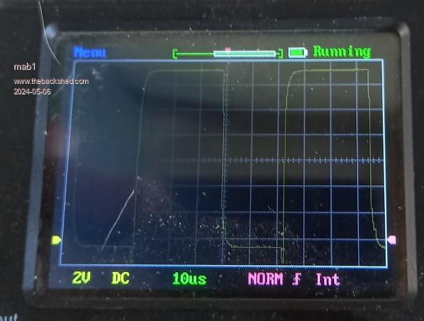

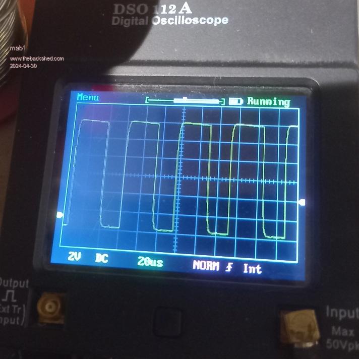

Not had the chance to do much more with in yet. I did try with my little pocket scope as that's good when you want to avoid unwanted earthing of probe gnd and don't have a differential probe. The side with 4 fets does appear to be working; and it appears to operate at about 18 or 19 khz  which was lower than i was expecting (i thought they'd run at very high frequency to use smaller inductors).
Gate drive for a remaining FET
But the pocket scope appears to have developed an intermittent continuity fault on its input which makes it a bit unreliable for verifying waveforms.

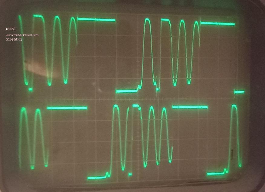

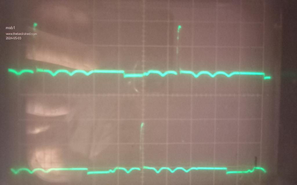

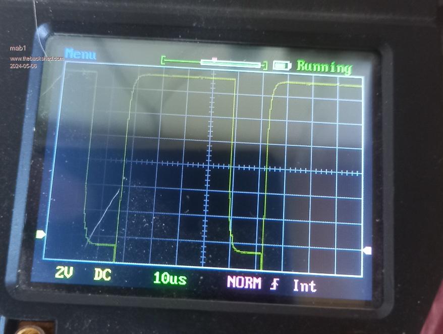

Ok, well I've given up on the pocket scope for now and fired up the tektronix 564 this only does 1MHz with the current plugings, but it does do dual trace allowing me to compare waveforms. As this unit seems to run at 16.67kHz (60uS period) it should suffice (don't know why i thought this unit would run at much higher frequency).
Here's the comparison of voltage on the two big inductors left and right, showing that both sides are working even though one side is down one highside and one lowside FET:

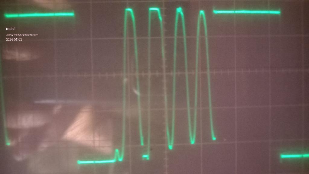

And here's the gate drives comparison of the left and right lowside FETS (synchronous rectifiers as Nick said):

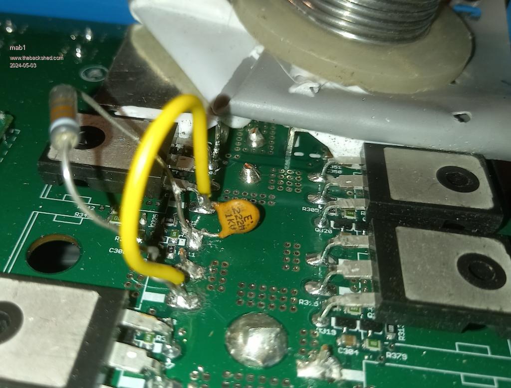

I put a 910ohms and 2n2 cap gate-source in place of the missing highside FET and compared with one of it's two still working(?) Parallel sisters (NB, due to the alternating scope trigger setting i was using it looks like they're not in sync, but of course they are). The one without the wiggles is the resistor and cap:
Repeat for the lowside FET:
So, as far as i can tell, the gate drives are still working.
Sorry my scope pics are not brilliant, but it looks to me like the rise of the gate drives is sharper with the 910ohms and 2n2 than with the FETS.
Edited 2024-05-03 07:38 by mab1

I will go out on a limb and tell you what I see - and that is the low side gate drive is essentially non existent and when it is there it is at the wrong time and for an extremely narrow width.
The picture above the comment "So, as far as I can tell, the gate drives are still working "
I think tells a story. Looking only at the top trace, the beginning of a highside drive waveform starting in the second grid area is the top FETs on and bottom FETs off, energy into inductor and load. Note the low amplitude only around a volt + & - is due to the drain coupled energy back to the gate, coupling via the D/G capacitance
About half way through the 3d grid line area is the bottom FETs body diode conducting as there is no gate drive visible (yet).  After the body diode conduction finishes, the waveform starts the decayed ring, after one cycle of ring we finally get a very short period of a gate drive, not sure of your scale 5/10V? it looks to be either a 9V or 18V gate drive - I will go for 9V.  The FET drive in the decayed ring is just wrong.
There are all sorts of possibilities, one likely one is that the FET drives are determined by a micro controller that is not doing its job properly, maybe due to some collateral damage from the shorted FETs or issues with a sensing circuit component.
For low currents/power throughputs the bottom FETs dont need to be switched on to short the body diode for efficiency as there is only low power involved but at higher powers you definitely want the FETs on period to essentially mirror the body diode but there is usually a small caveat. The FETs are switched on just after the body diode starts to conduct and are switched off simultaneously or just prior to the end of current conduction as the energy in the choke can no longer sustain current flow to the output.
Looking at the gate drive picture again, you see a very narrow pulse long after the body diode conduction period and during the normally decayed ring period. Also interesting is that the high side FET also appears to turn on again briefly immediately after the bottom gate drive is turned off, however no upper gate drive is evident from the picture above the lower narrow gate pulses to explain this.
It is possible that during the narrow on period some energy is put back into the inductor from the output capacitors and released through the top trace flat area as the top FETs body diode conduction returns that energy back to the input + rail. A bit like an unintended boost converter cycle.
Hope this helps - just be aware that for low powers maybe a very narrow gate on period like that is ok or normal (but not WHERE yours are showing), many high powered synchronous buck converters dont bother with FET drives below a defined output power as the gate drives energy required is often around the same as what is recovered due to the increase in efficiency and it is more difficult to determine small changes in current for lower powers so they often only drive the synchronous FETs when there are decent current levels to detect when to turn the FETs on and off.
Last comment maybe this is just an acceptable quirk of their design and under much higher power throughputs all these waveforms start to behave normally, but its not how I would leave a design to go into production.
MAB - I hope the CRO fairy visits you one night and leaves a nice present....

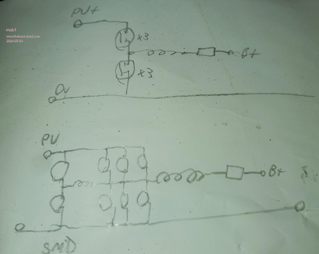

Hi wiseguy, thanks for you thoughts. After i posted it did occur to me that the lowside gate pulses didn't show up where expected, but as you say I'm running at very low power so far. But also i was thinking it may be something to do with the additional smd FETS under the ally plates - i can't reach their gates to see what they're doing.
I've done a pencil sketch of what i think the circuit might be: the upper drawing is sort of the typical syncronous dcdc converter i was expecting, the lower is what it looks like - as far as i can see without dismantling (and makes no sense to me):-
I did notice when the mppt was hunting up and down, the narrow switching event in the ringing would widen as the main switching even on the left narrowed (moving to higher input voltage), and visa versa.
Maybe if i try running it at higher power it'll look more reasonable? i could also check if the remaining 4 FETS warm up evenly (all working) or some remain cold (not working).
TBH my lack of understanding of the circuit tempts me to options 1 or 2 as it's quick and doesn't cost anything.

The schematic you have drawn I can't really make sense of, I expected it to be just 2 x independent paralleled buck converters with their output chokes summed.  In my experience of working with FETs If there are more than 1 in Parallel and a FET or FETs are shorted, they usually "took one for the team" and the others are probably fine.
