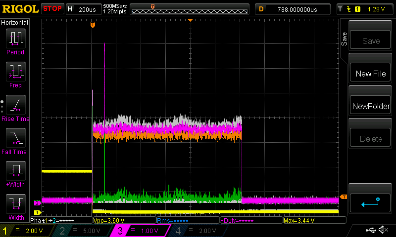

results after the changes (discussed below) can be seen here
The White trace is before mods
Orange is house running on street power, sort of the best I could get
Purple is after the mods.
The Green trace is the same as the White trace but with 10dbV/division
Vertical scale is 20 dbV, and the peak is a 1V p/p sine wave at 2kHz
20dbV is the same as a factor or 10 change in voltage.
So the noise is about 60db down from the signal.
60db down is 1/1000th of the voltage.
The scan width is 0 to 25kHz over those 6 divisions
So it appears I "halved" the EMI since the purple trace is about in the middle
of the other two. It might only be 1/3 less due to the log scale but it's
worthwhile to get.

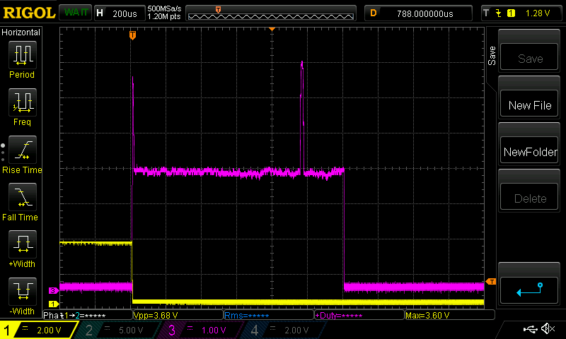

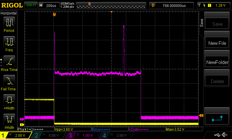

All the inverter components are inside a metal enclosure. I have two clip on
ferrite chokes on the 240V output cable and these are about 1 foot outside the box.
The above traces are not time averaged. Each is the result on one scan only.
Below are traces where I averaged 8 scans, to smooth over the noise variation
and give a clear indication of the average noise level.
I chose different scan settings
0 to 2,500Hz
1024 frequency bins
and average 8 scans
This is with the inverter off:
and with it on using the modified design
This is not bad at all. I want to compare this with the clean power/room
I enjoy at work, to see what is possible here at home.

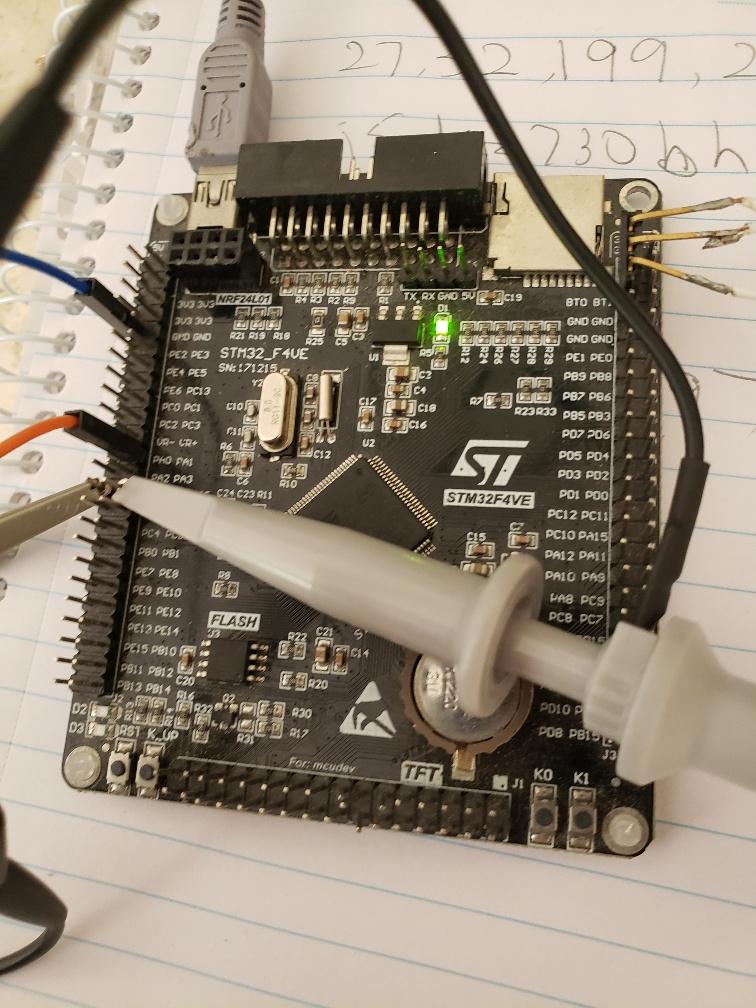

The board looks like this:
