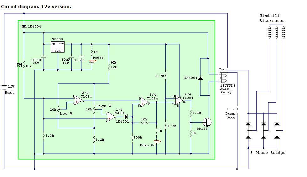

i build this charge controller( https://www.thebackshed.com/windmill/articles/TL084-Controller.asp )
everything seems to be working  beside the low voltage relay release from dumping
the relay clicks in to dump at 14.91 vdc
but when i lower voltage the relay clicks out again at 14.84 vdc
I cannot seem to be able to get it to release at a lower voltage like 12.6 vdc
anyone has any ideas as to why?
thank you.  ron

What happens when you adjust the 10k pot connected to pin 5 of the TL084.
Sum voltage readings around TL084 2/4 might shed sum light.
Have you tested all the resisters are the correct value.
12.6 is way to low 13.8 would be more like it.

let's work through this together. I am not good with analog stuff.
(It's going to be a lot of thinking out aloud)
First thing I would do is prove the 8V is in fact 8V that supplies everything.
I want to see it be 8V when switching the relay or not.
once that is done,
The circuit appears to be 2 comparators (2/4 and 1/4) , one amp with hysteresis (3/4) and another comparator (4/4) that drives the BJT and relay
You could check that both low and high trim pots can turn on and off the their comparitor's outputs. These outputs will be a bit less than 8V when "on"
comparator 2/4 and 1/4 both share a reference voltage that is compared with
the trimpot's voltage. The ref voltage comes from the battery is divided by the
10K and 3.3K divider.
the divider's output is 0.248V per Volt on the nominal 12V input.
12V input will give 2.977 V
This should appear on pin 6 and pin 3 of the quad op-amp.
What battery voltage are you testing with? check for your divided voltage.
trimpots can output a voltage from 2.172 to 4.821 Volts
and this depends on the 8V supply.
This corresponds to input voltages from the battery of
8.76 to 19.44 Volts. Maybe prove you have these voltages
at either end of the trimpot's positions.
That is a start for my understanding of how it's supposed to work.
If we have all the above OK then it's time to look at the 3/4 op amp
and how it's supposed to function

nothing really when adjust the high pot.
when i adjust the low pot it will change the voltage from 14.91
all resistors right vallue
ron

Further information on testing that circuit here.
https://www.thebackshed.com/forum/ViewTopic.php?FID=2&TID=16338&LastEntry=Y#211422#211371
Posts: 3412
Posted: 04:01am 26 Nov 2023
  Quote  trimpots can output a voltage from 2.172 to 4.821 Volts
As the pots are in parallel I get 2.60V to 4.19V (assuming the regulator output is 8.00V) but the principle is the same.
With your multi-meter (-) probe on Bat- and the (+) probe on the middle pin of each pot the voltage must vary between those limits as you rotate the pots.
If not you must find and fix that problem before you can go any further.
Report back here what voltages you get for the regulator output and at max. and min. for each pot.

I have on the high trim a range from 2.56 volt to 4.20 volt
I have on the low   trim pot a range of 2.57 volt to 4.20 volt
i found however a possible problem with one of the 4004 diodes
its the one running from centre pin bd139 to left pin 78L08
when i test diode in circuit i have voltage drop of 0.081 and reversed 0.082
diode test perfect when soldered out of circuit
ron

tl084 pin voltages
1   7.35
2   2.57-4.20 depending on pot adjustment
3   2.88
4   8.02
5   2.56-4.20 depending on pot adjustment
6   2.88
7   1.49
8   7.35
9   1.49
10  6.90
11  16.8 --????  input from power supply is 12.42 volt , how could this be more
12  7.35
13  4.00
14  6.65
ron

i dont know whats happening  , but after typing all the vallues I connected it to power again and relay clicking out at 13.57 and engaging at 14.97
im at a loss   whats going on
thanks
ron

  Quote  I found however a possible problem with one of the 4004 diodes,
That is normal, the diode is in parallel with the relay coil so a diode test won't give a correct result.
  Quote  11  16.8 --????  input from power supply is 12.42 volt , how could this be more
Pin 11 is the ground pin for the IC so should read 0V. Probably a bad connection / solder joint somewhere.
  Quote  I connected it to power again and relay clicking out at 13.57 and engaging at 14.97
That it is now working is probably related to the same bad connection. Probing around may have temporarily fixed it.
For reliability you will need to find and permanently fix it. Start by checking pin 11 then all other connections to Bat(-). If they are all good check all the others.

could i set high to 17 volt?
Posts: 3412
Posted: 08:57pm 03 Dec 2023
R1 sets the operating range. Increasing it from 10k to 15k may do what you want.
However the point of this circuit is to protect the battery from overcharging. If you are using a 12V Lead Acid of any type don't go over 14.5V. For a longer life 14.0 to 14.2V is better. For longest life, 13.7V.
