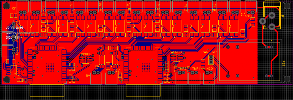

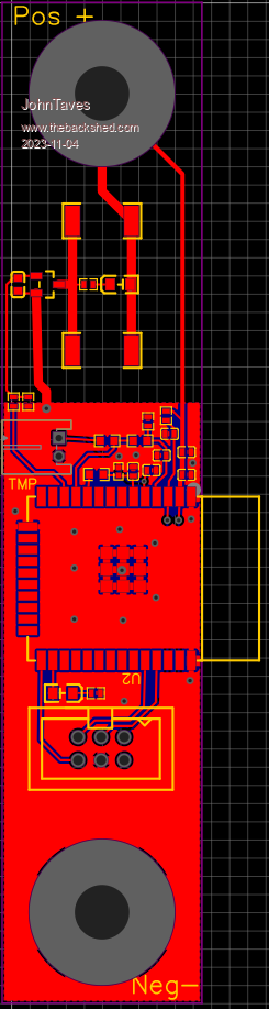

I made two esp32 based boards. One, the cell module, measures the pack voltage and temperature, and sends the info via bluetooth to the controller board. The controller board has a pile of SSRs to control things, a CAN connector, and bluetooth and wifi.
The cell module, has the form factor where you simply bolt it to the terminals on a prismatic cell that you buy from alibaba. The temp sensor does require you to wire a thermister and tape it to the cell. This board has 2 20ohm resistors in parallel that the software will turn on, potentially for hours, to give that cell a haircut if it is the first cell to reach the top V. The software can ensure that no one cell is always the one to reach the top V. These report their measurements every 2 seconds, and are asleep between measurements. After I implemented the sleep feature, I was unable to measure the amps. Prior to that it matched the expected ESP32 drain of a few tens of milliamps. Nobody will get excited about the ability of the esp32's A2Ds, but I find them totally acceptable for measuring cell voltage. They seem good to about +-.01V. I figure that I have no need to run these cells up to 3.65V which is supposedly the max. I stop at 3.5V so it makes no difference if the cell was really 3.52 or 3.48.
The controller board has 2 esp32s. I got tired of trying to get a single esp32 to do both the wifi and bluetooth. There are 16 total SSR outputs that are used to turn on/off loads and charging. There is a CAN bus that I use to capture the data from 2 Reidon SSD digital shunts. One shunt measures the pack voltage and amps, and another measures the solar amps.
It has input for 4 different resistance measurements. Two are used for the temperature in the front and rear of the RV and control the 2 furnaces, one of which will heat the water bay where the batteries are to ensure neither freezes. Another reads the water level resistor in the fresh water tank, and another reads the propane gas level resistor.

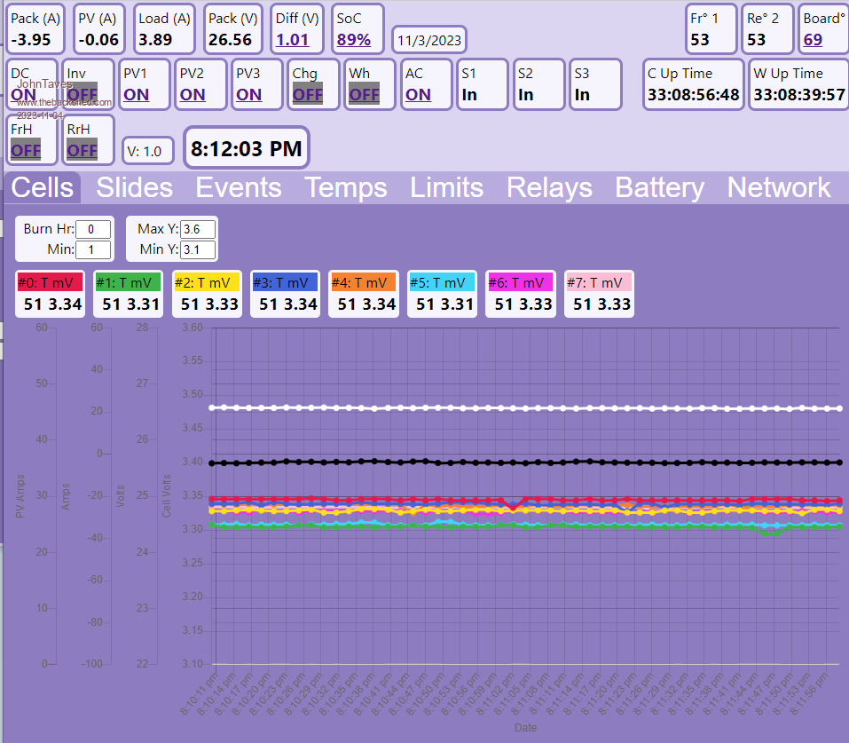

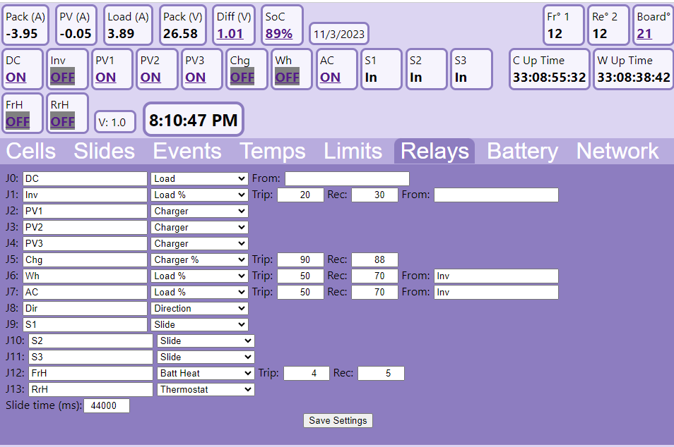

The software provides a web page where you set the # of cells and the various cut-offs and recovery values. The temperatures and gas and water levels are shown on the web page (the screen shots are from an earlier version, so no water or gas level).
The software does coulomb counting to monitor pack state of charge. I have it set to stop charging at 95% and turn charging on after it drops below 90%. This means that the pack is almost never at 100%. I have my settings such that 100% is when any one cell has hit 3.5V and the pack amperage is less than 12 (I have an 2p8s 280ah so 13kwh total).
It will turn off the main cabin air conditioning if the pack state of charge goes below a certain %, and same with the electric water heater, which reverts to gas.
When any one cell drops below the minimum voltage, the DC/DC converter is shut off along with the inverter resulting in only the current necessary to power these boards.
