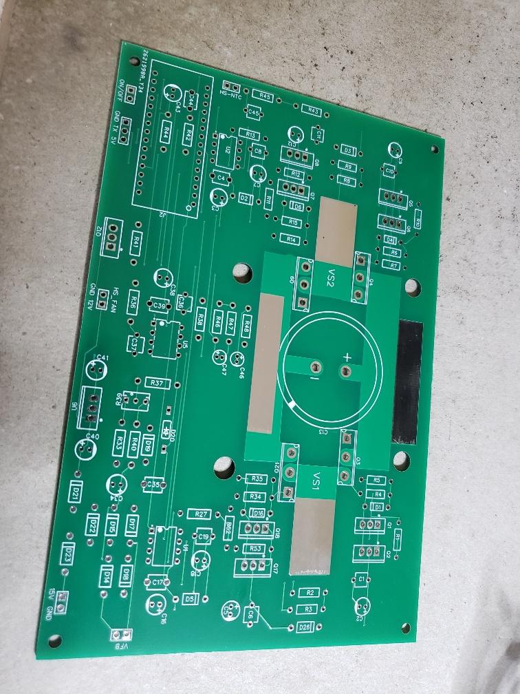

It's all in one, except for the 15V supply. With a 12V battery, a boost
converter is needed. 48V supply needs a buck. I was not going to put a buck/boost
on it.
Only one HY4008 per leg of the bridge means it's good for about 1000W easy
and maybe 2000W peak. Testing will show if it's up to the job.

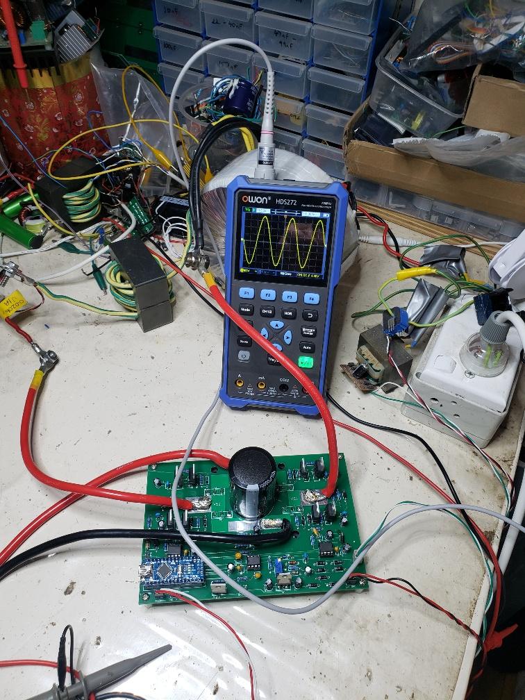

I just built it and it has good output. It runs picoverter code.
This is at 52V DC supply.
with 240V output, it's only 0.22 Amps at idle.
thought I would put the portable DSO on it.
(danger: all grounds on that device are connected, including the USB charge port
so that means the USB port is 240V AC relative to one of the inverter's output)

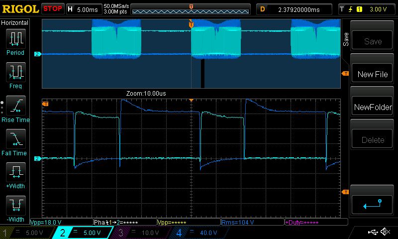

The Gate voltages are really nice and clean.
Here is the low and high side for one of the half bridges.
Dark Blue is high side, Light Blue is low side
High side vertical scale should be 5V/div not 40V as shown.

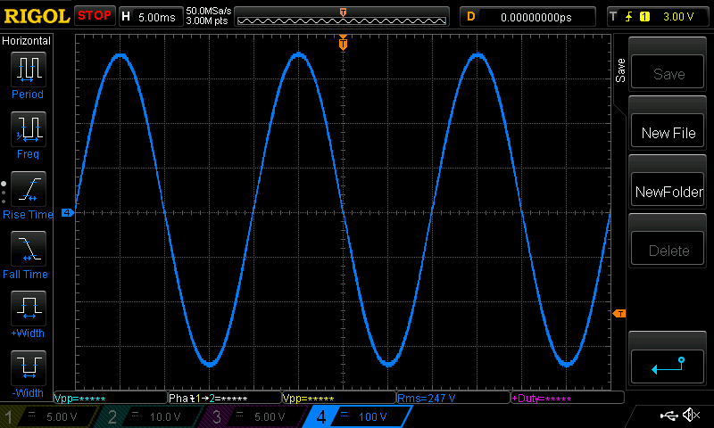

here is the AC waveform at 400W (1.0 power factor)
It's remarkable that the FETs stay nearly room temp, even with 20 second
tests at 400W. The Victron 12/375 needs to run its fan with 100W loads.
This is a good result.

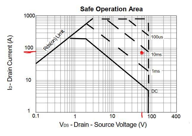

Safe operating area from the HY4008 specs is this:
The 1ms and 10ms needs to be swapped, they made an error when doing the graph.
The Red dot is 70 Amps at 50V which is the peak power point of the test.
What is the duty cycle width for these safe operating area graphs?
anyone here know?
I think the 2400 Watt test is getting right up there to the device limits.
The heat sink got a small amount hotter than ambient. Building in a fan
will make it robust at my estimate of 1500 Watts continuous.

Its a single non repetitive pulse.
But with the FET on and passing 70A you would not have had a 50v drop across drain Source

one day I will understand this.
I suppose Drain-Source voltage would be DC supply minus whatever is output
into the primary.
The PWM system of ours is repetitive so how to work out what is
OK according to specs?
I just showed that 2500 Watts at 50V through
one FET is possible. But I would like to know that it's
"acceptable" from the manufacturer's point of view.

As @pd-- noted the graph is for the simultaneous combination of Id and Vds so mainly applies to the switching transition when both Vds and Id are significant. As that lasts much less than 100uS you are on safe ground.
Edit
For a simple resistive load that will be 68 / 2 = 34A and 50 / 2 = 25V
For a complex load with very low PF (eg an induction motor at start-up) you may be closer to the limit.
