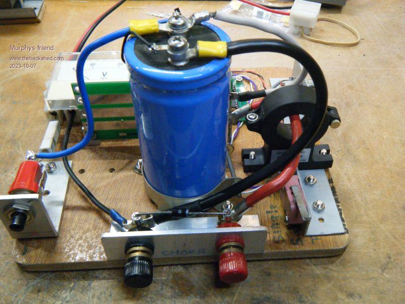

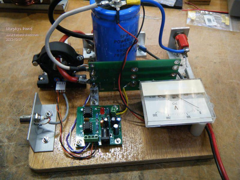

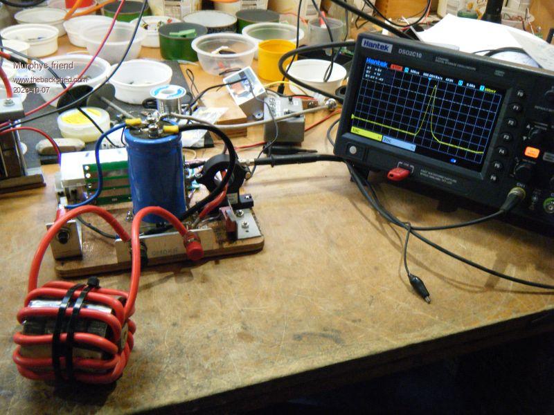

For that I made a tester which looks like this:
First I tested how the capacitor dumping its full charge into a short circuit looks. I had to charge it only up to 10V or the trace would shoot off the top of the screen.
The yellow trace represents the current sensed by the Hall sensor. One vertical screen division equals 100Amp. This applies to all the following traces.

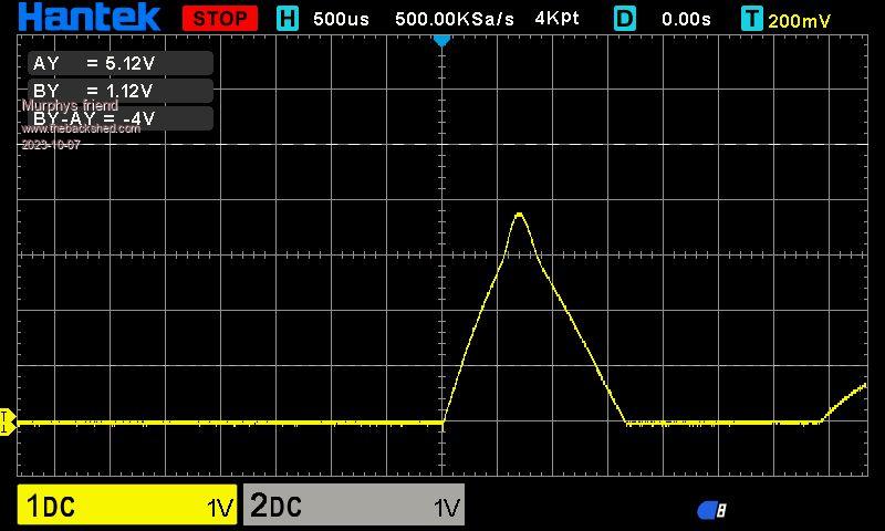

Next I tested a toroidal choke with 12 turns. The capacitor charge was charged to 30V, as it was for all the following tests. That choke measured 90uH on my FNIRSi DSO-TC3 tester.

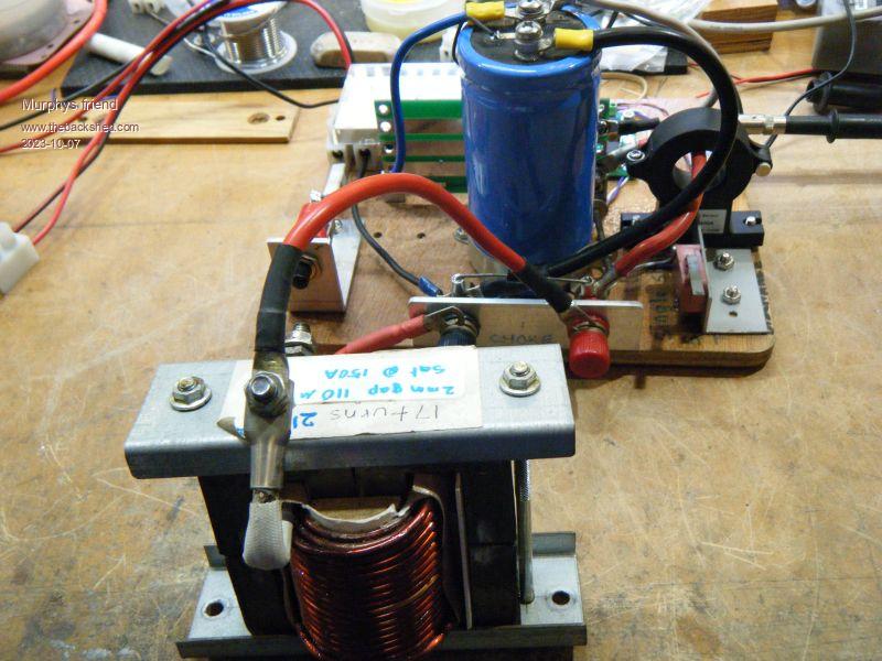

Then I tried a silicon steel E core, 17 turn, 110uH
Followed by another toroidal choke. 10 turn, 3 ring Sendust material, 40uH

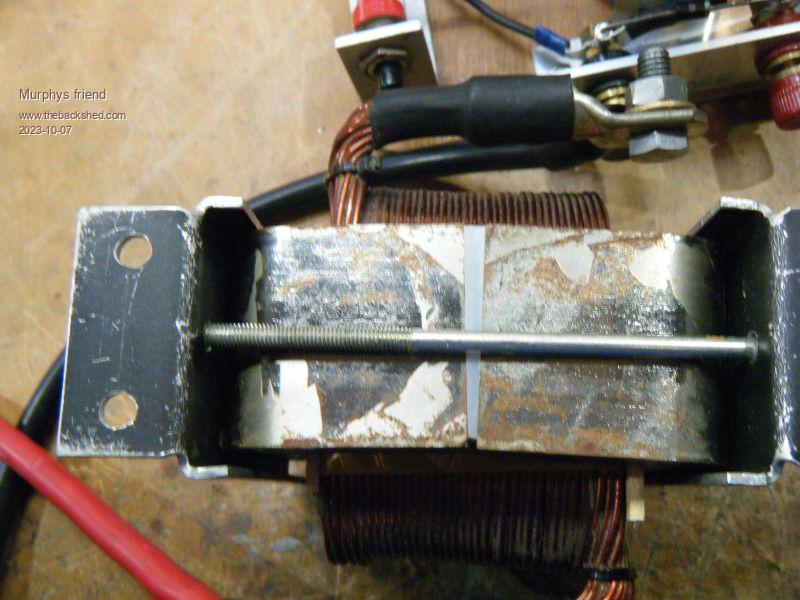

Another silicon steel choke, this one  a C core with a 'swinging' gap. 12 turn, 40uH

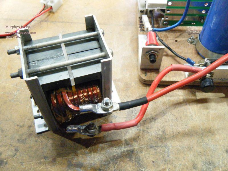

Lastly a dual ferrite E core choke, like we used at the beginning of inverter building. 20 turn, 6mm gap, 130uH.
If anybody is interested in doing similar tests I can post the simple schematic for the tester. The inexpensive FNIRS DSO mentioned above has a single shot capture feature and works - trigger setting is a bit tricky and the traces are on a much smaller screen as shown here.

Ooops, it looks like I confused some pictures, unfortunately the editing feature does not work for me.
So, the trace shown after the 17 turn silicon steel choke belongs to the 12 turn toroidal choke.
The trace for the 17 turn choke looks like this:

Thanks Aaron. The capacitor is 7500uF/75V, ex old fashioned power supply - found it in my parts box.
Do not use too big a cap, I tried initially 2 x 10000uF and had to use a very low charge voltage or the trace shot off the screen.
The mosfets I used can handle about 1000A peak, the biggest peak in the pics is about 750A.
Initially I used 2 x HY4008's, they did not last long. it would require 4 in parallel if that type is chosen.

Hi Klaus, since I've been looking at winding some chokes for my MPPT I've been trying to make sense of all this info  ...  but am a little lost as to what I'm looking at.
So to set me straight  ...  you've built a system where you charge a cap up to 30V and then dump it into your test choke.
The discharge lead feeds through a current sense coil so you can monitor the waveform on your DSO.
What does the analogue meter read? I see it has a 300V FSD. Is that just to show what you've charged your cap up to  ...  or is it somehow used as an analogue ammeter? Peak test pcb?
Then my main questions  ...  what are you actually looking for? What makes one choke better than another?  ...  and I assume that also depends on the application? Thanks.

Hi Roger, That analog meter is something I found in my parts box. I removed its serial resistor and the FSD is about 60V now. The meter is just there to see how far and when the capacitor is charged, you could easily use a multimeter instead.
I am looking at the up slope of the trace. You can see above that with silicon steel cores (as you have) the slope ramps up to a point and then takes off almost vertically. That is the point at which core saturation occur. You want your peak inverter currents below that point since the choke no longer does its job beyond that point.
With the Sendust ring core chokes the trace is very different, it ramps up in an exponential fashion. This tells me saturation is more gradually rather than sudden as in the silicon steel cores. Picking a saturation point with the sendust core chokes is not exact, I chose a point where the trace slope roughly matched the silicon steel choke before saturation.
For an inverter I do not want the choke to saturate at the expected current, I suppose the same applies to the MPPT choke.
I find that ferrite E cores saturate at a much lower current than similar sized silicon steel cores, for that reason I do not use them in my inverters.
You are right, the saturation part depends on the application.
If you, or anybody else, is planning to build the above tester keep in mind the very high peak currents involved (hundreds of Amps) and choose the parts accordingly.
The trigger switch is tricky, it needs de bouncing as the mosfet can switch very rapidly. Even so, I found a micro switch with a long lever arm best for an instant trigger as this needs to be done right after the cap is fully charged.
BTW, the above traces were among the first I took with my new DSO so keep in mind that the time scale could be shown better.
It's a great piece of gear but does require a longish learning curve .

Thanks Klaus, that was very helpful  ...  and I did wonder if you had modded the meter to bring it to a suitable range.
When you said the time scale could have been shown better, I assume you would widen it out so you can hopefully see the change in direction/saturation point more clearly.
