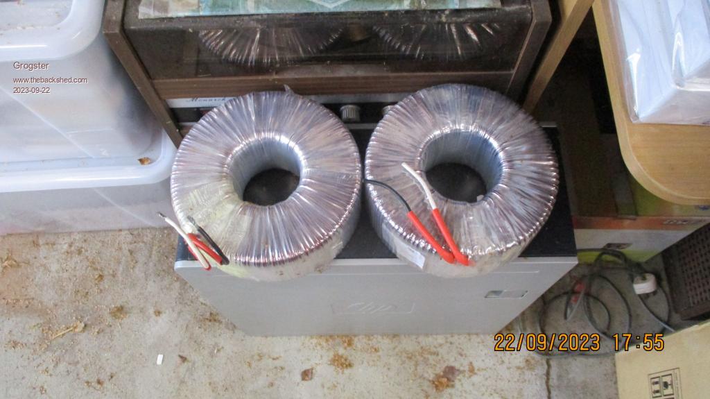

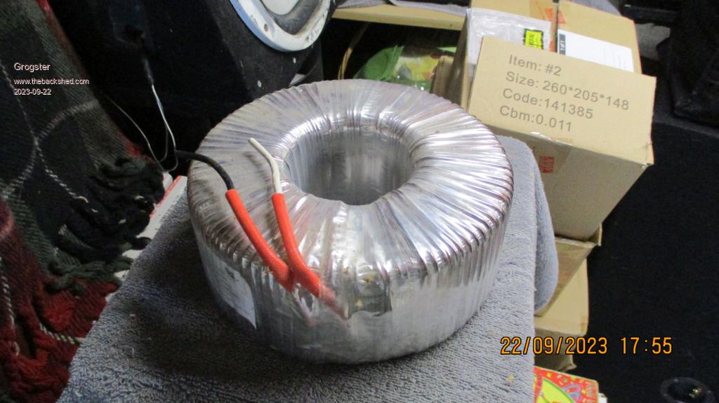

2x Toroids:
These only have ONE winding on them, so they seem to have had one winding removed already, and look to be ready to accept the chunky LV winding directly - I think.
3kW units, so good for up to 16A surge I would imagine - please comment.

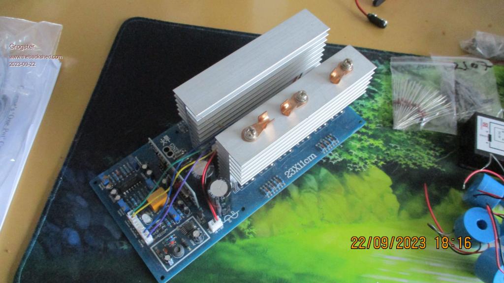

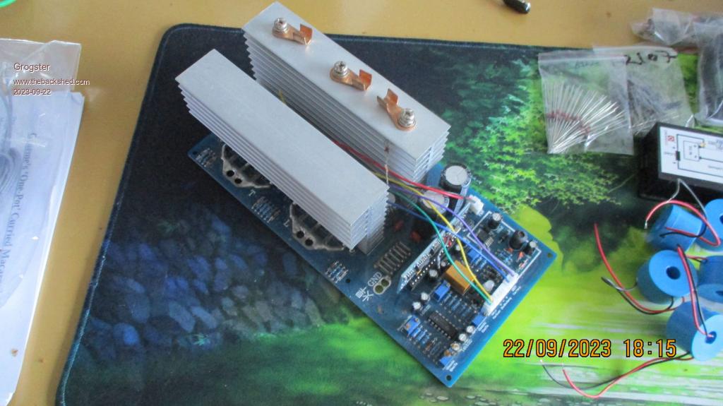

Pre-assembled inverter board:
As I understand things, as of NOW, this board is no longer a good choice, mainly due to lack of robust MOSFET gate drivers, and so the MOSFET's can pop without too much abuse on these boards.  I am currently researching the "Picoinverter" controller paired with a Madness power board as suggested in the other thread I was linked to.

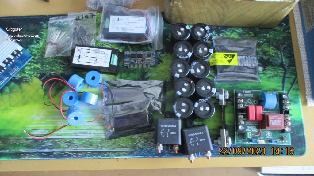

Other bits:
Diodes, couple of LED panel meters, LCD panel meters, CT's, 200A relays, 10,000uF 100v electrolytic's, fusible-link, my attempt at a current and voltage feedback module, and a bag of twenty HY4008 MOSFET's.
The mission-critical thing is the toroid's, and so with those, I am hopeful I can try to build something that works for the modest power requirements I plan to have.
Any and all comments welcomed.

  Quote  3kW units, so good for up to 16A surge I would imagine -
One Toroid will easily do that , with forced cooling you could get 5kva out of one
peek current would be more like 50A for 30>60 sec , its just dependent on the FETS in the inverter and battery assuming you do a 48v version.
There is nothing wrong in running a transformer worm especially in a cold damp environment.

I don't see any choke core amongst the parts in the photo's.

  Revlac said  I don't see any choke core amongst the parts in the photo's.
You don't.
Cos I don't have one.
I would welcome suggestions.

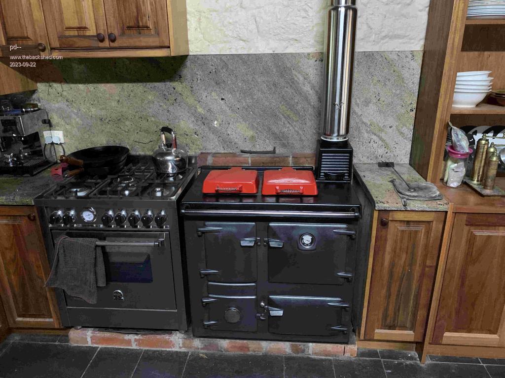

Posted: 10:38am 22 Sep 2023
A flue heat exchanger works a treat
Hear is a pic of our Rayburn with a axeman fireflue the HWS is behind the wall and above the stove.
