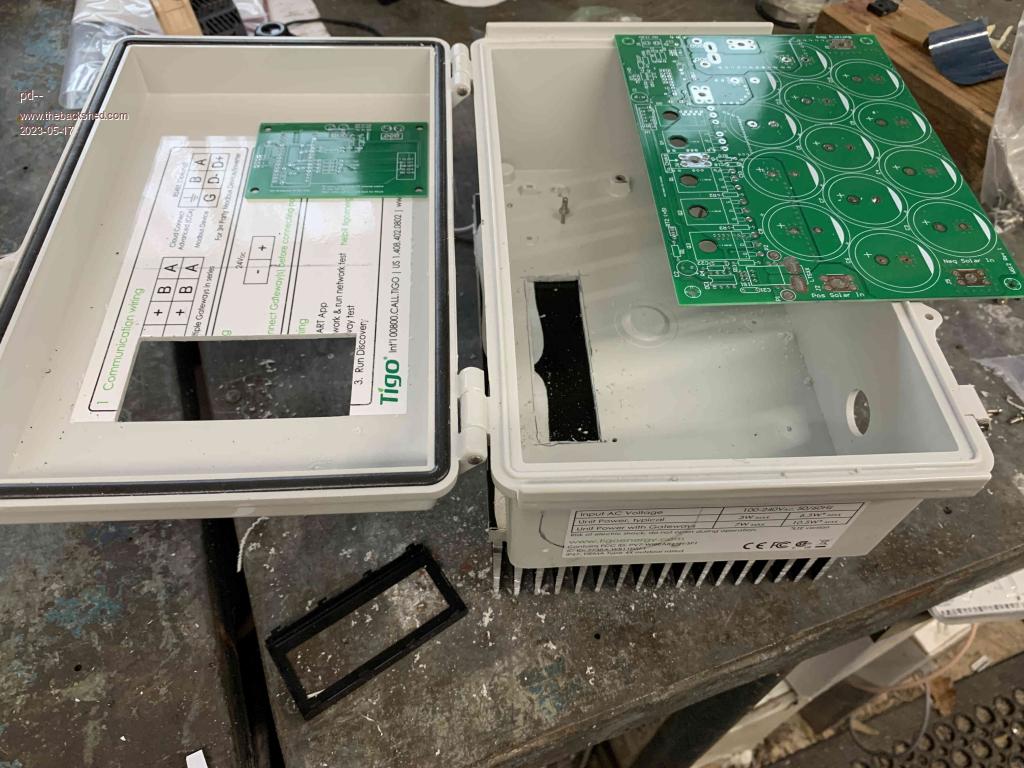

The charge controller is slowly taking shape
Im using a plastic case that was lying around with a hunk of aerosharp inverter heat sink bolted to the back.
Thers a slot cut into the back of the case for the fets to mount on the heat sink
and the controller and display mount on the door

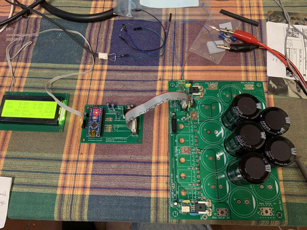

The Electronics is coming together, After my early run in with a dud cpu
everything is running as expected.

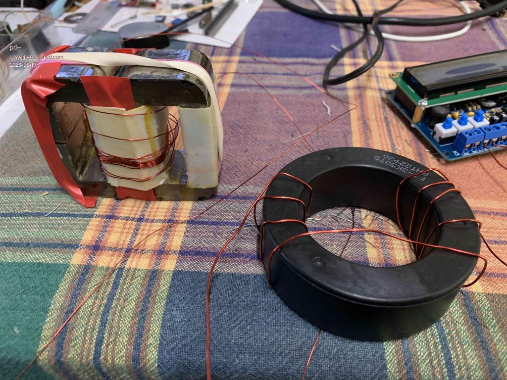

Looks like il use an old aerosharp core for the choke.

Yes, very nice, and thanks for posting the clear photos.
I was just today admiring the boards that I had ordered, this will be my next project, I have everything I need to get one going, but not before cleaning up the mess I've created with my last project.
