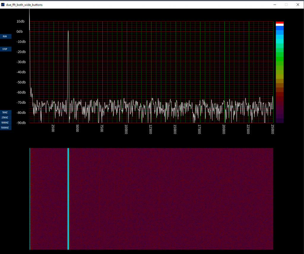

I always wanted a better display of the frequency spectrum of things
compared with what I can get from the Rigol DSOs I have.
Finally got the urge to write some code, to use what I have at hand
so no extra cost. And all open source tools.
The program shows the freq spectrum of a signal in two ways.
One is what it is right now, with a vertical scale in dbV
(20 dbV = 10x difference)
and horizontal scale being the frequency.
The other is the spectrogram waterfall, with colours representing voltage.
This shows how the spectrum changes over time.
this is what it looks like
Bits you need:
a PC running Win10 or something. I had it working on the iMac running OS 10.9 too.
one Arduino Due (about $12 on ebay)
Results and specs:
Input voltage range 0.0 to 3.0V DC with respect to the Due's ground
0.0db = 1.0V signal, peak to peak.
4 K sample window
about 70 db signal to noise ratio
4 frequency ranges (5kHz, 25, 100 and 500kHz)
very decent update rate (see video here    )
14 Hz at 25kHz setting rising to 30 Hz at 100kHz
and then it's about 40Hz update with the 500kHz setting
(5kHz frequency range is very slow since it takes a long time
to get 4K samples at a 10kHz sample rate)
The Due has a 12 bit ADC and that means a signal to noise ratio of about 74 db
is the best you can hope for (the famous 6.02 x Nbits + 1.74db equation)
When the input gets near 3V p/p a bit of distortion appears, usually 2x and 3x
the main peak but this is only at -60db or about 1/1000th the peak's value.
It was huge fun to program and I am amazed how well it works.
Two programs to download and install. Processing4 and the Arduino IDE.
The spectrum program  is
due_fft_both_wide_buttons.zip
and the code for the Due is
high_speed_adc_due_buffer_handshake2.zip
If anyone tries to use this, you will need to alter the COM port name in the main
program to suit what it is on your computer.

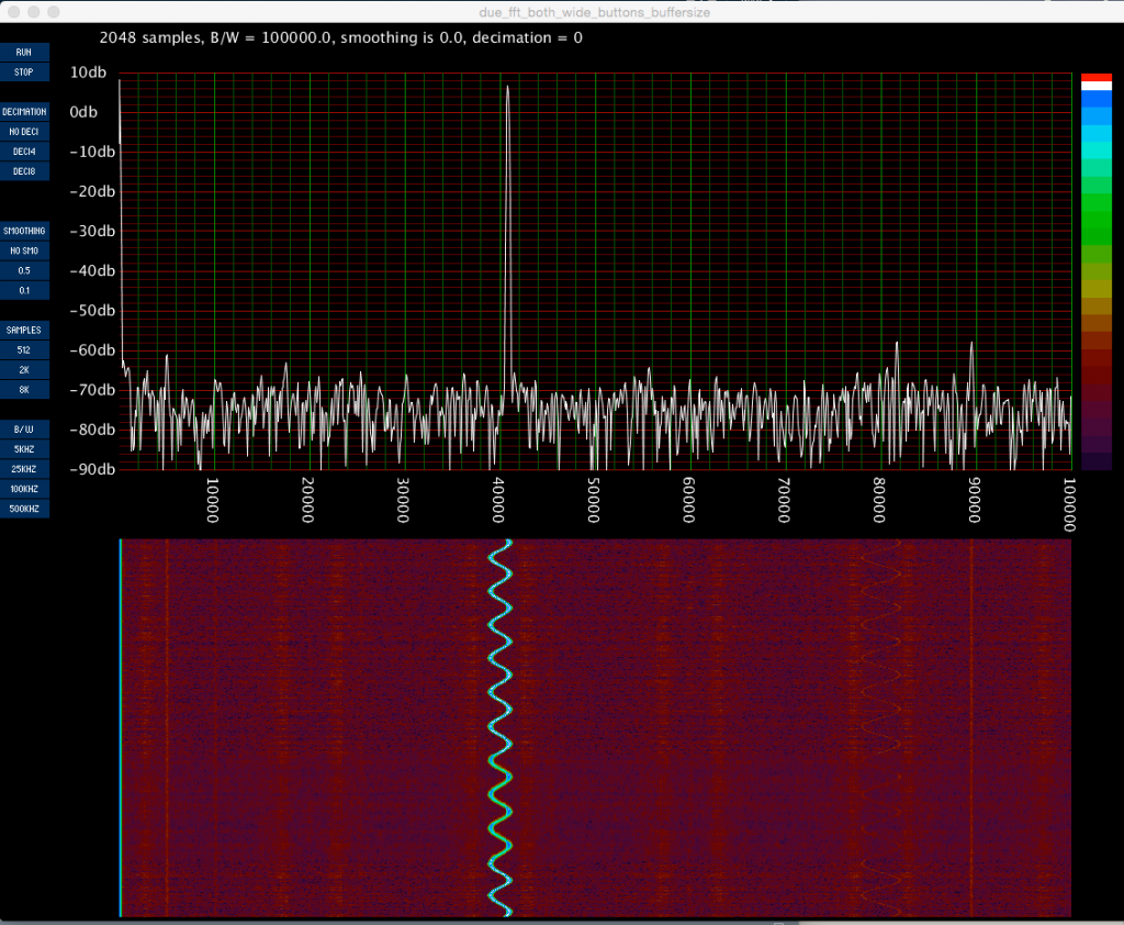

The program has become more advanced after further work.
Now you can choose the sample size (512, 2K and 8K)
and also smooth the spectrum over time to squash the noise.
