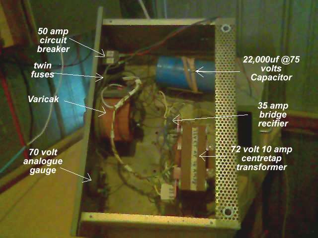

Posted: 10:54am 27 Mar 2006
Thanks for that link Glenn  it looks a heap easier way compared to the siliconchip conversion they did a couple of years ago. Next time I'm down the hill I'll have to get meself a couple of puter power supplies and give it a go but I do have an old power supply I got made about 10 years ago that outputs upto 60 volts at about 10 amps off memory. It's basically a huge transformer, a few rather huge caps and a variac with fuses installed and a 70 volt analogue guage to set the volts. This power supply was originally made for my tape drive motor which is nearly ready to go up as a wind genny. I reckon it could make a neat battery charger which I'll cerntainly need for my shed array's when winter sets in. That's if I'm home and not away working 4 weeks out of 5.

Hiya Guy's,
               Here's a pic of that power supply I mentioned above. As it's overcast today I'm going to power it up and give my 2 array's in the shed a bit of a charge.
