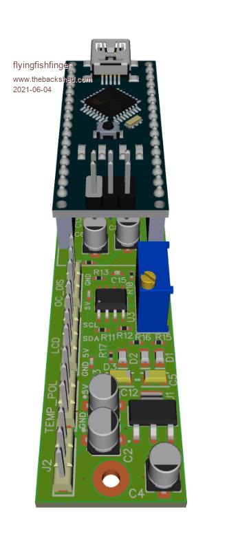

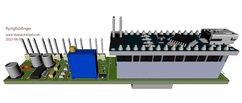

I've adapted his Brainboard for Wiseguy's Powerboard layout to fit right ONTO the 10-pin connector in a bid to reduce cables running around the place & keep things short. I've made a few changes:
- Added a hardware comparator & P-FET that could be used for a hard over-current shutoff. This is an adaptation of Poida's attempt at controlling this with a software interrupt, but I have no idea if it'll work yet.
- Added a few 0.1uF capacitors to decouple the 5V supply to the Nano and the LCD, I want to try to get the I2C display working properly. Should generally reduce noise.
- R, G & B LEDs - everyone needs Blinkenlights! For extra indicators.
- Optimized routing for the 10uF filters a bit, this should reduce the noise on the analog readings.
I don't have a 3D model of the Powerboard (wiseguy?) to check the fit with, but I'm 98% sure it'll fit.
I'm about to order some along with the Powerboard, and if it works I'll be happy to share the Gerbers for anyone who wants to try it.
In the meatime, here are schematic & screenshots if anyone's interested. I'll report back on how things go.
MPPT_NanoController.pdf

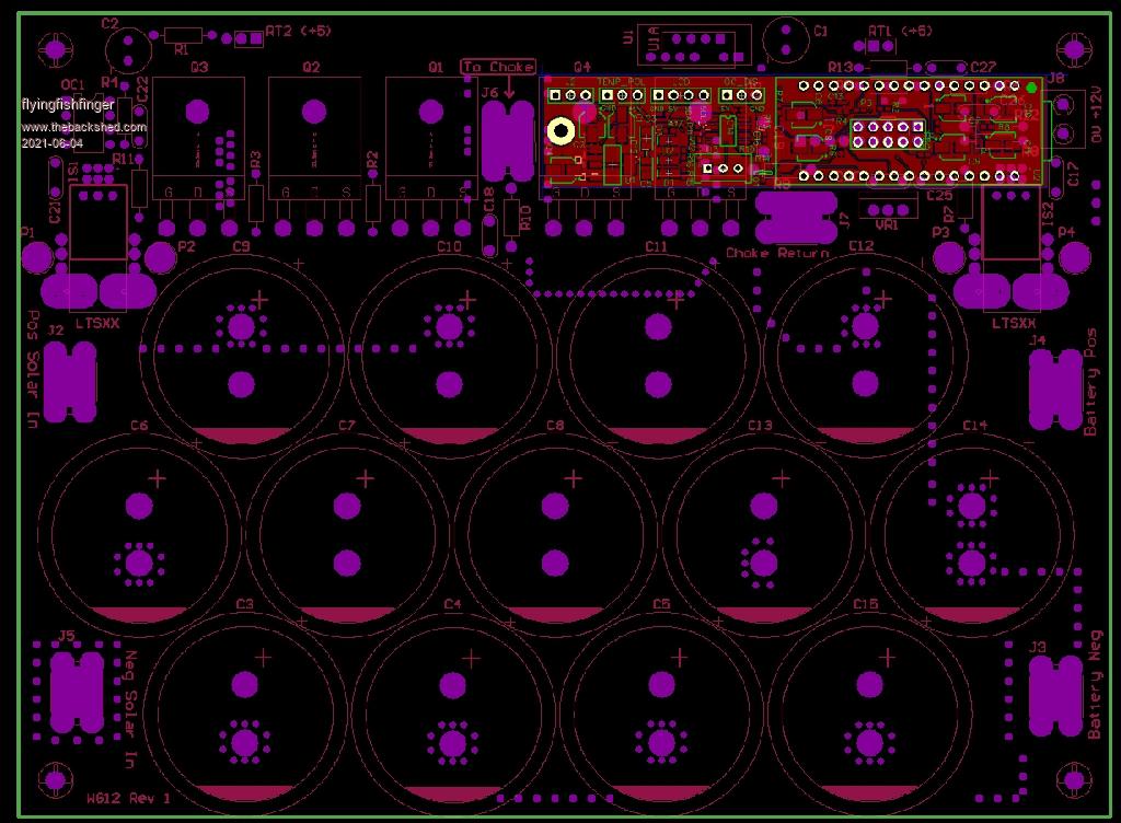

"I don't have a 3D model of the Powerboard"
Nor do I Rafael - sorry.  I need to create 3D models for all of my components - its on my to do list - I can just see it if I use binoculars......
I do need to get around to it though - takes out a bit of the guesswork and I will need my vernier & sample components a lot less when I design PCBs.  I have looked at how your pcb should fit and I dont think it will foul with anything. A component on my PCB could maybe be inserted on the underside if it helps.
Cheers Mike

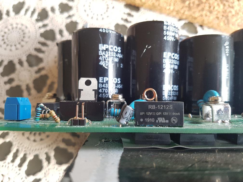

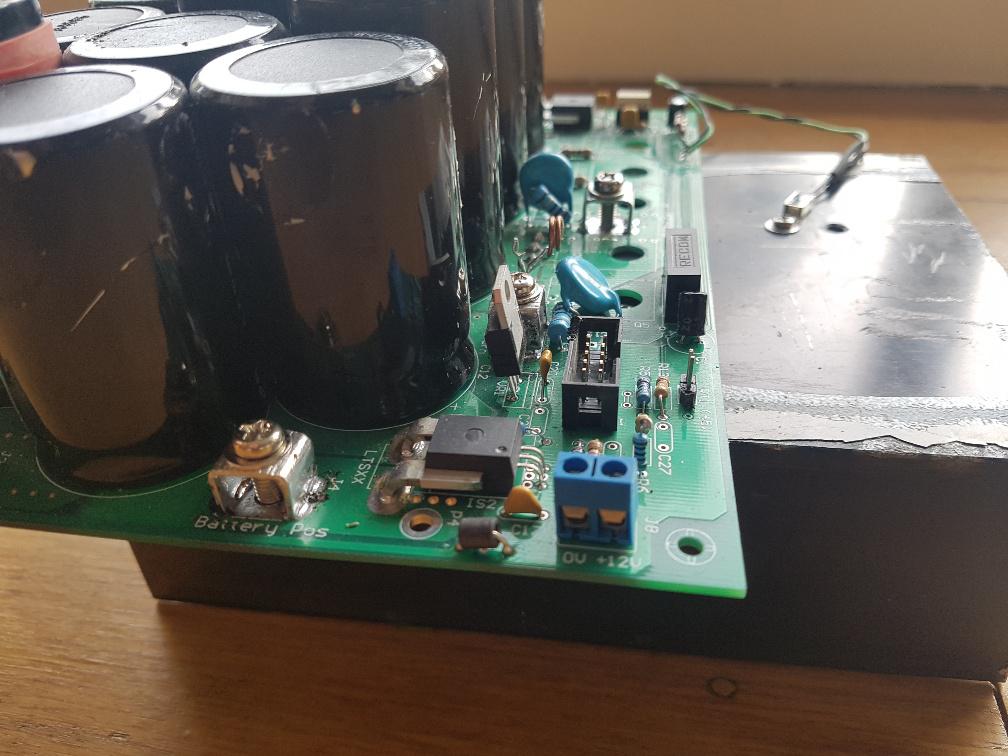

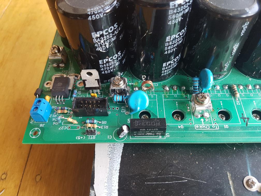

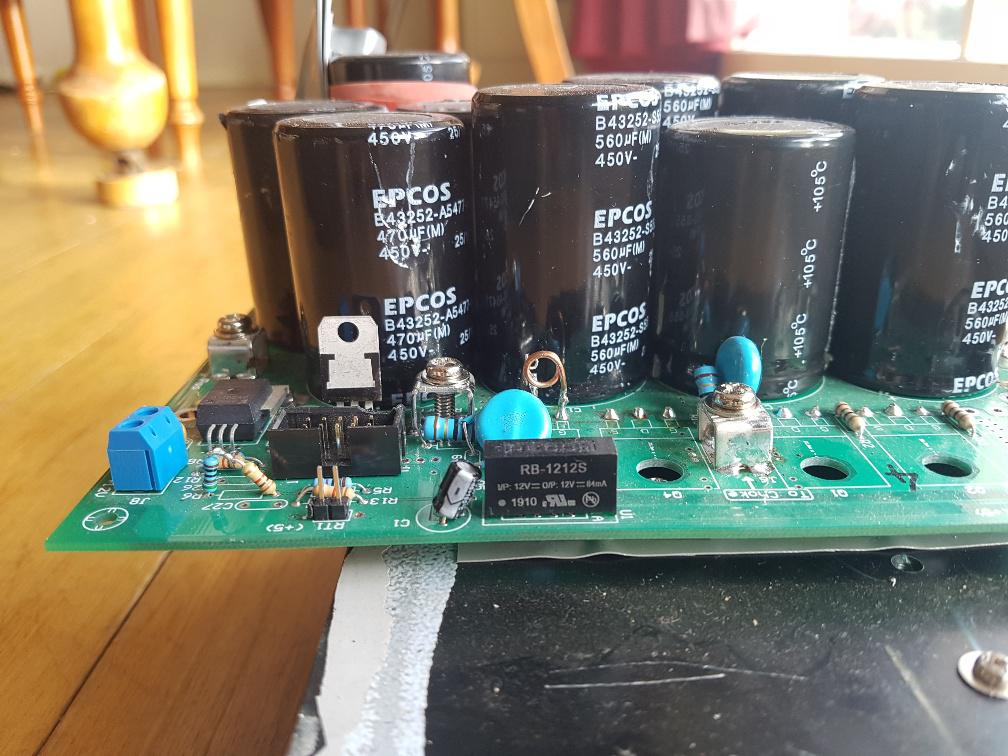

Rafael,
here are a couple of photos of the built board, to help you see what space there is
and is not.

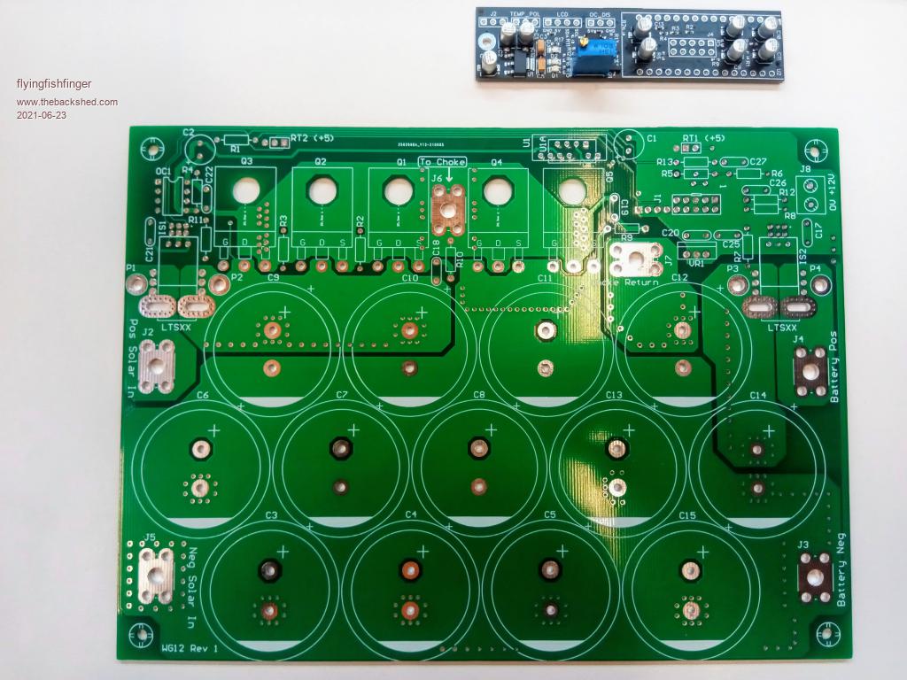

I got PCBs, check them out! MOSFETS from Aliexpress arrived too.
Now I need order the rest of the parts... I haven't found anything to salvage a choke  and heatsink from yet, sadly.

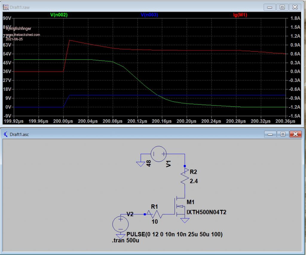

You're right, I didn't do the diligence for my part selection. Here it is:
The HY5110 has a total gate charge of 356 nC. We have a 10Ohm gate resistor in the design, so that means at 12V we can sink as much as 1.2A into EACH gate starting at t=0.
At 1.2A, we will charge 356 nC in 300 ns (ignoring the Miller plateau and the fact that charging current drops as we turn on for the moment, so this calculation will be an overestimate).
But if we have 2 (or even 3 FETs) and we want to switch them quickly, we will need 2.4 (or 3.6) amps if the driver can source this much.
The FOD3182 can source 3A of current, so let's assume we've built with 3 FETs and are maximizing this current.
That means we're delivering 36W for 0.006 seconds, for an average of 0.216W. If we populate 3 FETs and therefore also have 3.3k of pull-down, that's an additional 43mW for a grand total of 0.26W.
The 10uF output capacitor will discharge to 11.89V at every cycle.
For fun, I simulated a very similar MOSFET in LTSpice. The numbers roughly check out - the FET starts carrying the full drain current after about 300nsec, and the peak gate current is very nearly 1.2A:
Cool! Thanks for promting me to do the analysis as well.

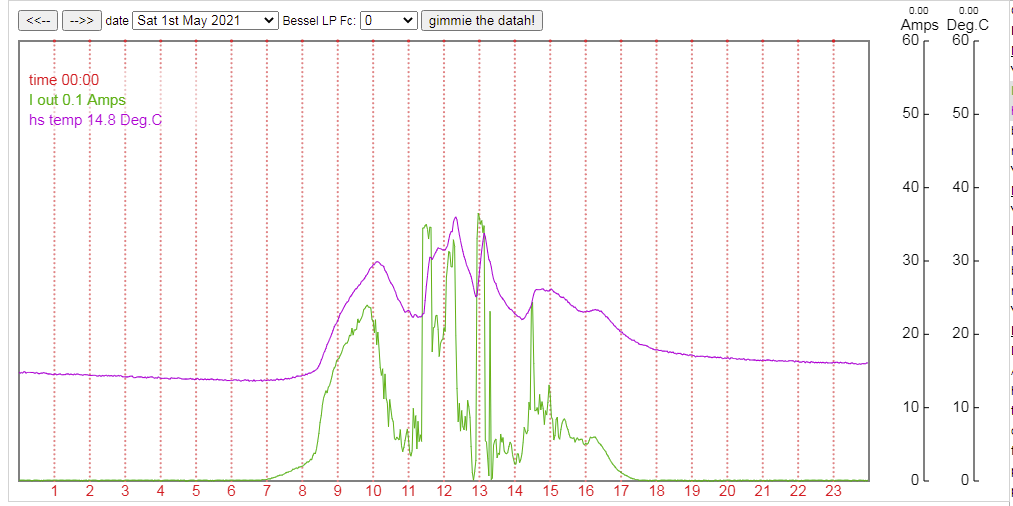

here is some data from my home system.
The output current and HS temperature for the mppt
connected to the 3kW North facing array.
I see no way the HS will exceed 60 C even if running at 40 Amps all day.
But this of course is highly dependent upon the HS size and
the HS used with this mppt is the same size as that shown in the
above photos.

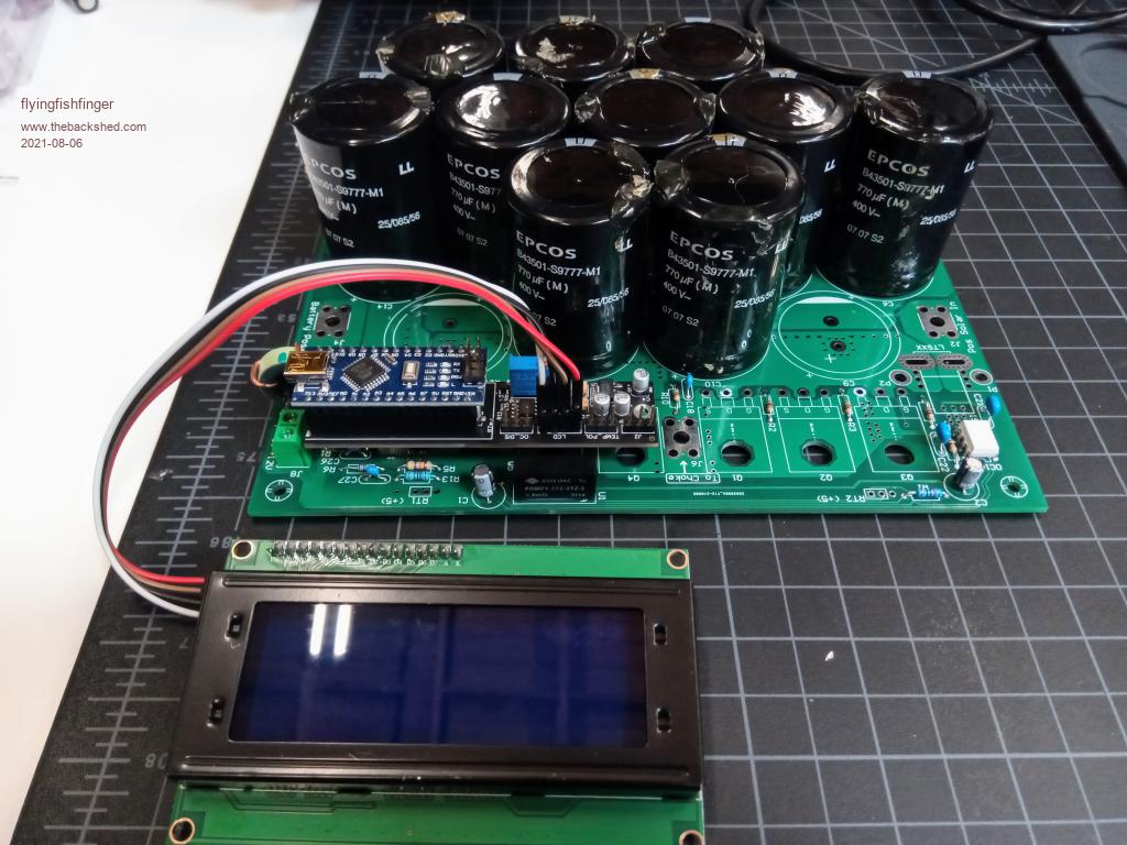

Sneak peek - still need to find wire to wind my choke and I don't really have a useable heatsink for the FETs :/
The LCD works from the controller board, but I haven't tested anything else yet...
R
EDIT: Shattered one of my new cores trying to gap it, guess testing is going to have to wait...
