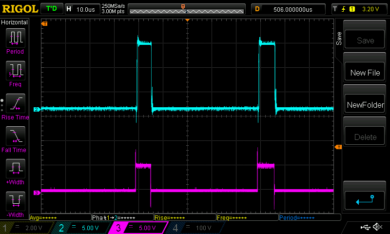

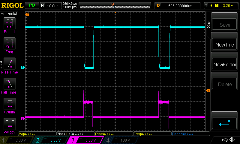

Purple is PWM IN, pin 1
Light Blue is low side output, pin 6
and now Light Blue is high side output, pin 12
The 5V pulse is converted to about 15V on both outputs.
