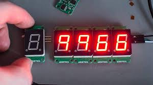

Posted: 01:16am 05 Jan 2021
Those red LEDs would look a lot nicer if you used a red plastic light filter.
It reduces glare and improves the contrast.
Without any filter
With a filter.
Edited 2021-01-05 11:30 by Warpspeed
